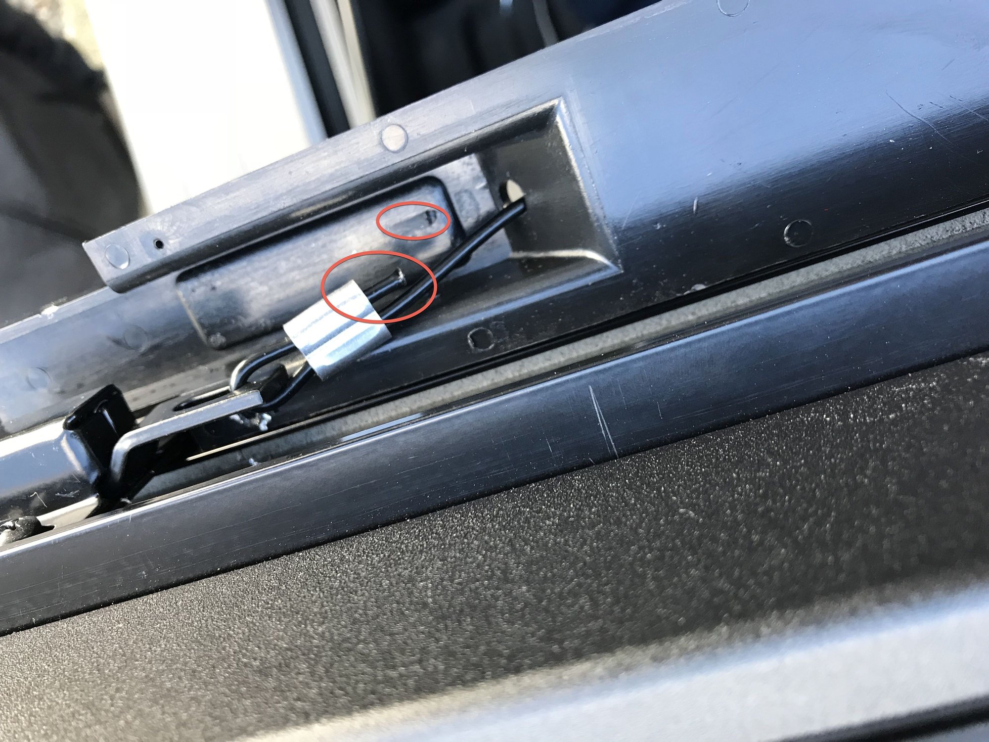

Hmmmm, I wonder if any of these issues are related to an issue I reported to them months ago. If the internal cables get crimped on upside down, they can catch and get stuck. I contacted Bakflip and send photos. They acknowledged the issue but didn't seem to care about fixing it. They simply said they would provide the image to "quality". I ended up fixing them all myself by cutting some of the plastic.
