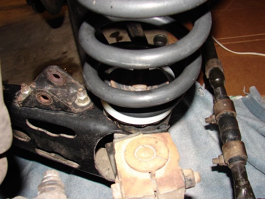

Just did some work on a 94 2wd with front end "clunk" noise.
Was the coil spring insulator at the base of the spring, completely gone on one side, disintegrating on the other.
The only way I could get the play to show was with shock loose & the arm at full drop.
I did the axle bushings too, the inner sleeves were worn to hell & gone, lots of play around the bolt.
Just a thought.

Thanks so much for writing. I'm a bit confused but very interested in what you're telling me. Looking at your picture the spring insulator you are making reference to.....Is that what appears to be a thick white plastic looking washer in your picture? If so, I don't think I have those. New springs, but I'm going to look and see if I have them. Hopefully you can let me know if my assumptions here are correct.
