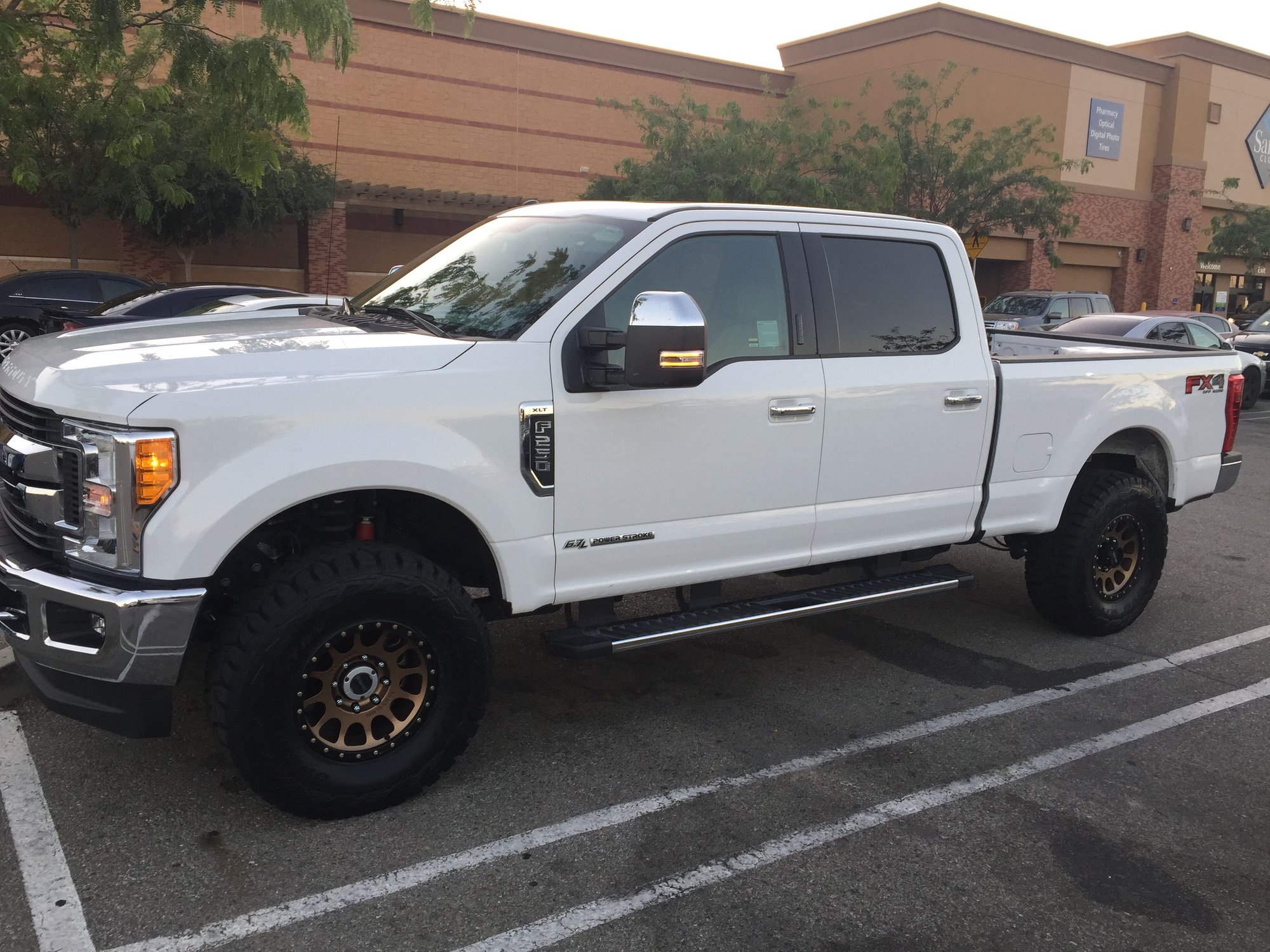

Originally Posted by Matthewyfz
I have 17” on my f250. I think they are 0 offset
Very nice! I'm trying to decide between the Methods (machined color), and XD Addicts. I've had 2 sets of the XD's in the past
yeah I think the methods are nicer rims.

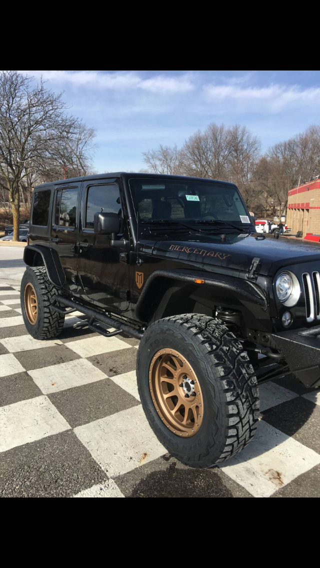

Bringing it back
Good Thread.
When I was a kid 17s were big wheels, tires were even bigger.
Im liking the look, don’t see it much anymore but it looks tough. I have never changed a set of rims on a car or truck but those methods though.
I know this pic is a Jeep but my F250 is black so that’s why the picture, kinda Smokey and the Bandit feeling no?
