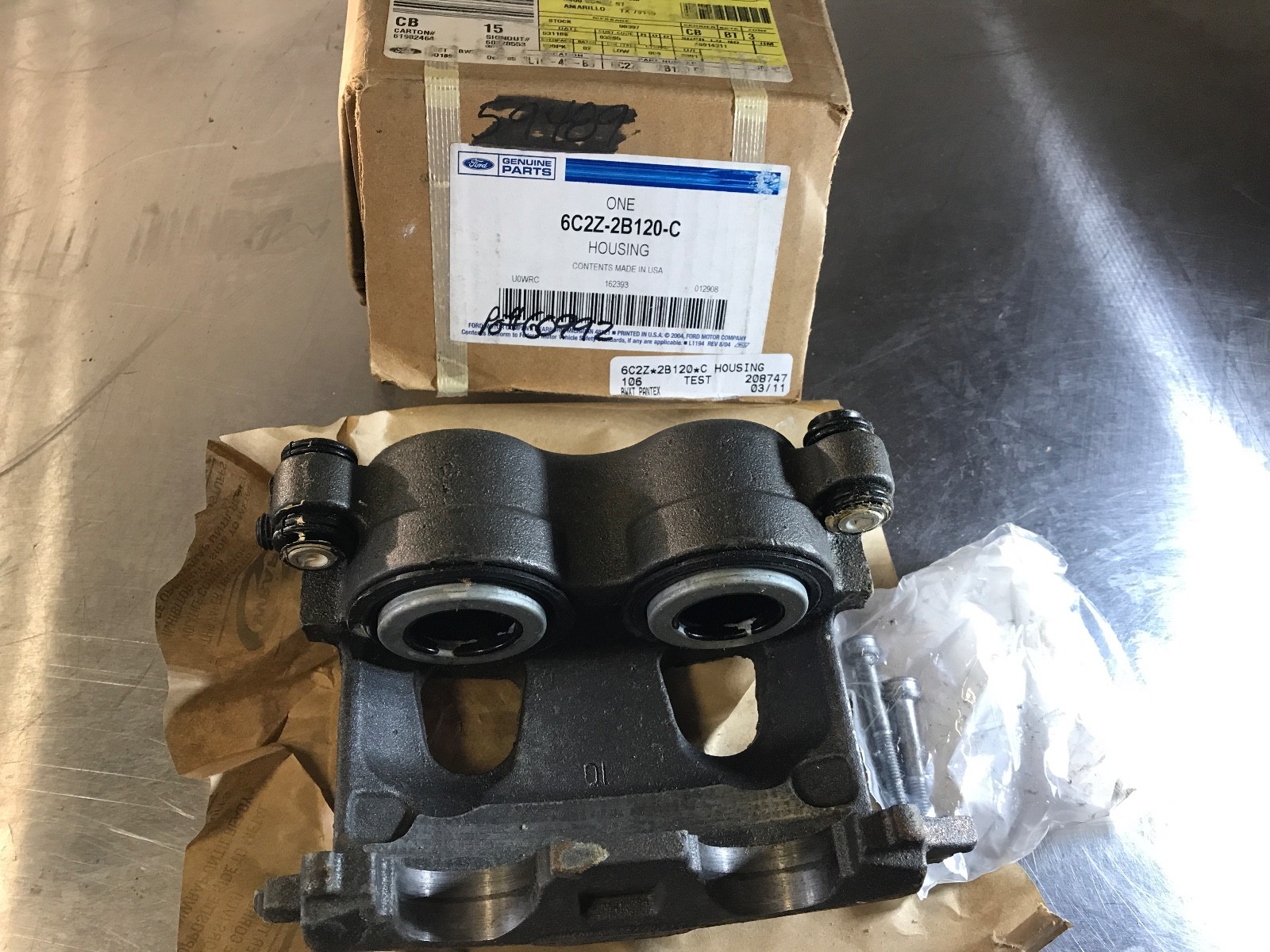

I found a new old stock Ford right front caliper on eBay for $50. AutoNation White Bear Lake (Tousley Ford) sells the same part that is remanufactured for about $110. Made in the USA! My buddy who is a power eBay seller found this for me. It's not from his store. He just knows how find good stuff for his E350 vans.

It would have been a whole lot better if you found the Left one too.

I am looking for the left front caliper too. It's working fine. I will wait unitl I find another new old stock product on eBay. I have 6 months to go before I use the van on a 4,000 mile camping trip.
I found a new old stock front brake hose for $30. I have an E150 van that's in top running condition that I use as my daily driver. Time is on my side for this repair.
