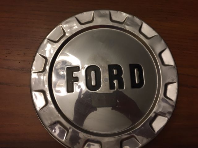

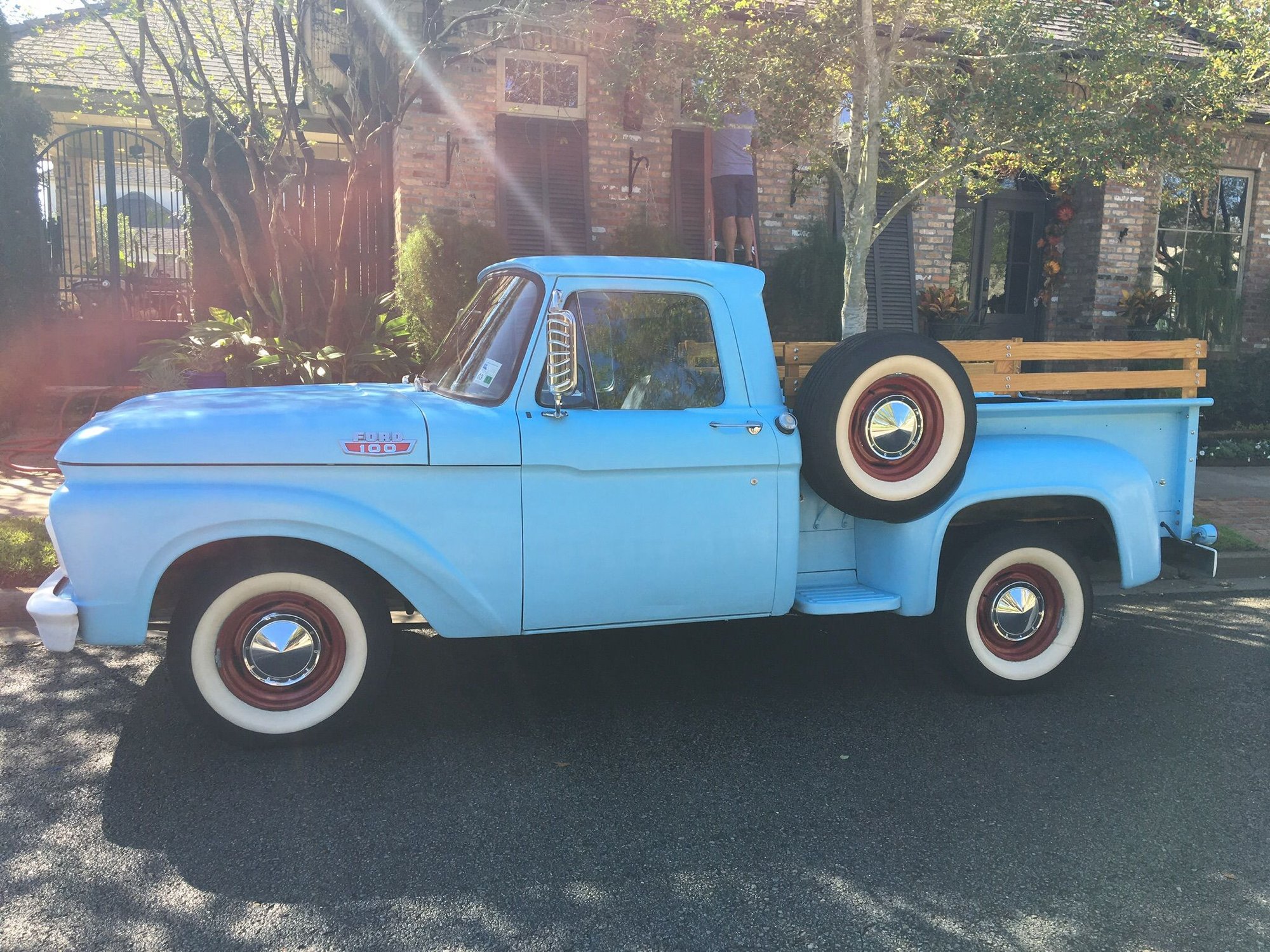

Can anyone tell me what these hubcaps came off of? I don't think they're stock on a '63

1960 FORD PASS CAR-

1961/62 FORD PASS CAR
Fixed it for you...
C1AA-1130-B .. "Outie" Hub Cap - 10 3/4" diameter / Obsolete
1961/62 Galaxie; 1962 Fairlane w/14" wheels.
The wheels are not original on the OP's truck, because they're "Outies" .. not available on F100's until 1965.

1960 - C0AE 1130-C -
1961/62 FORD - C1AA 1130-B
Ball's in your court Bill ...

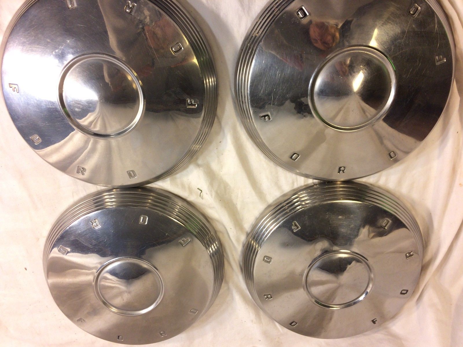

Here is what the originals look like...
I don't know the details of which had white vs chrome, perhaps someone else with more knowledge of this could chime in.

The hubcaps shown in the photo attached to the OP are 1960 FORD PASS CAR.
Where did everything else come from ...

These are 1962/63 Fairlane with 13" wheels.
