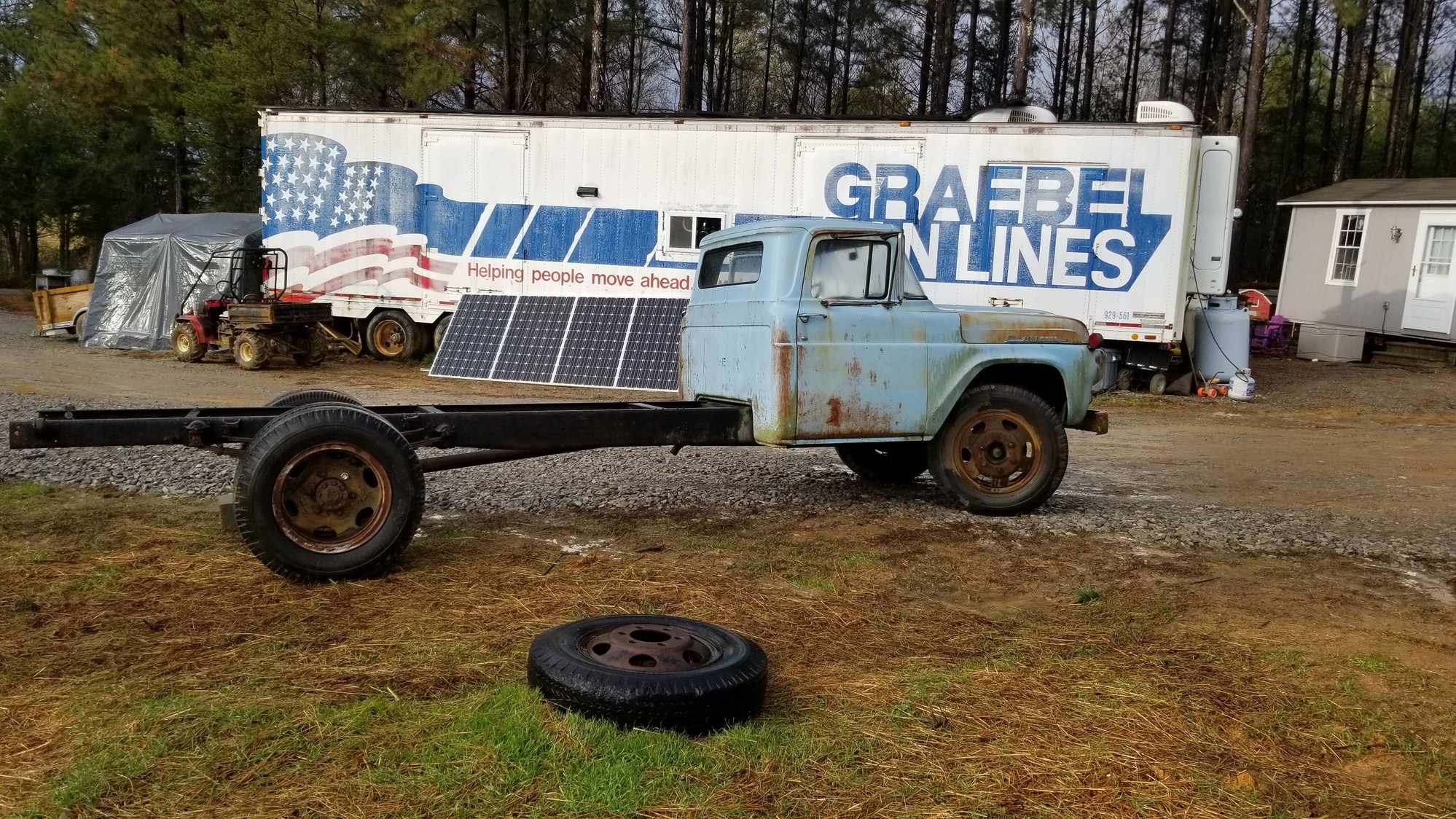

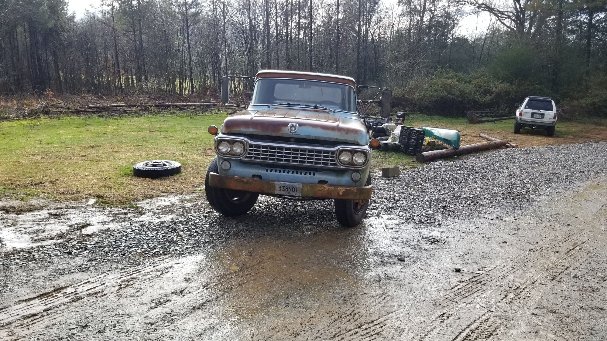

The day it came home

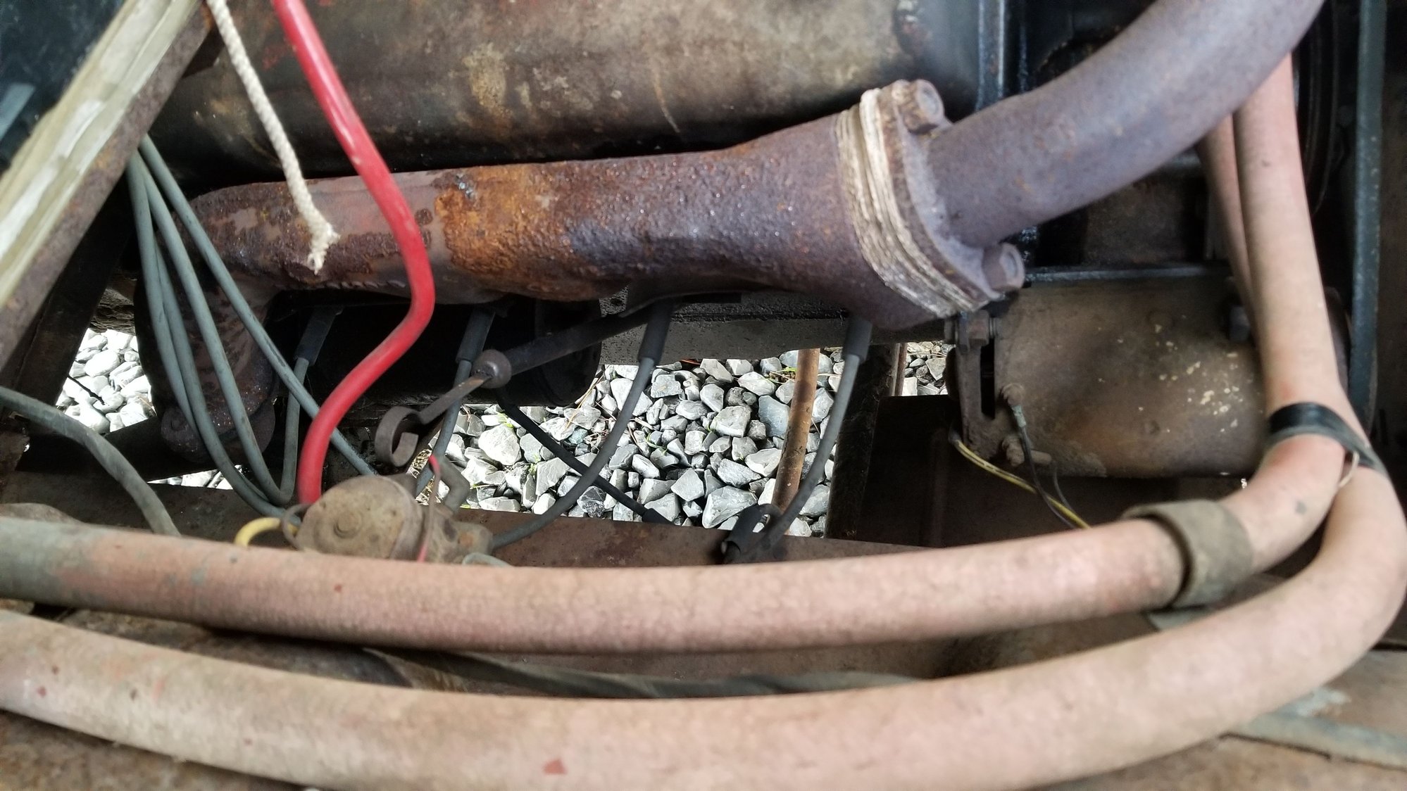

Manifolds looked pretty good to me

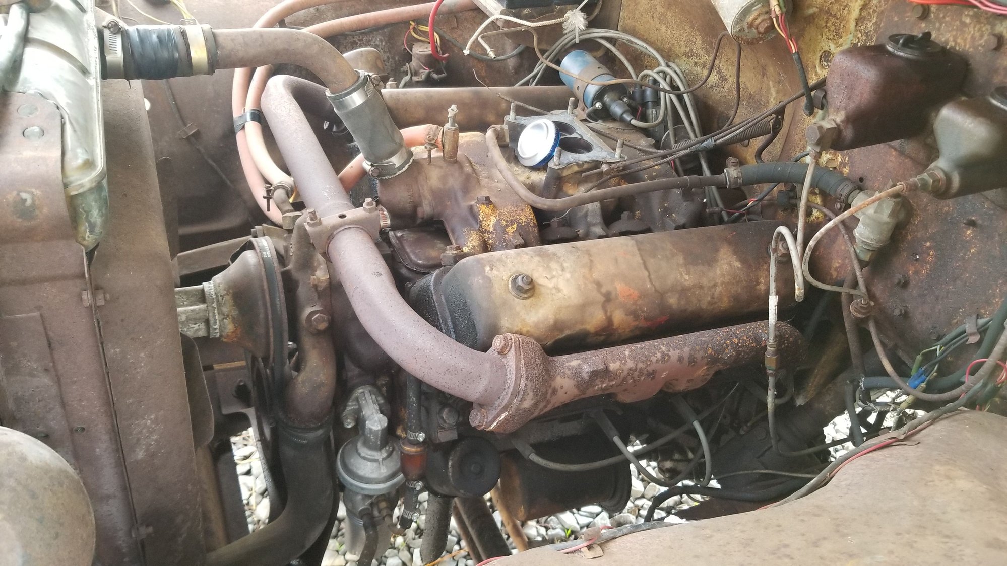

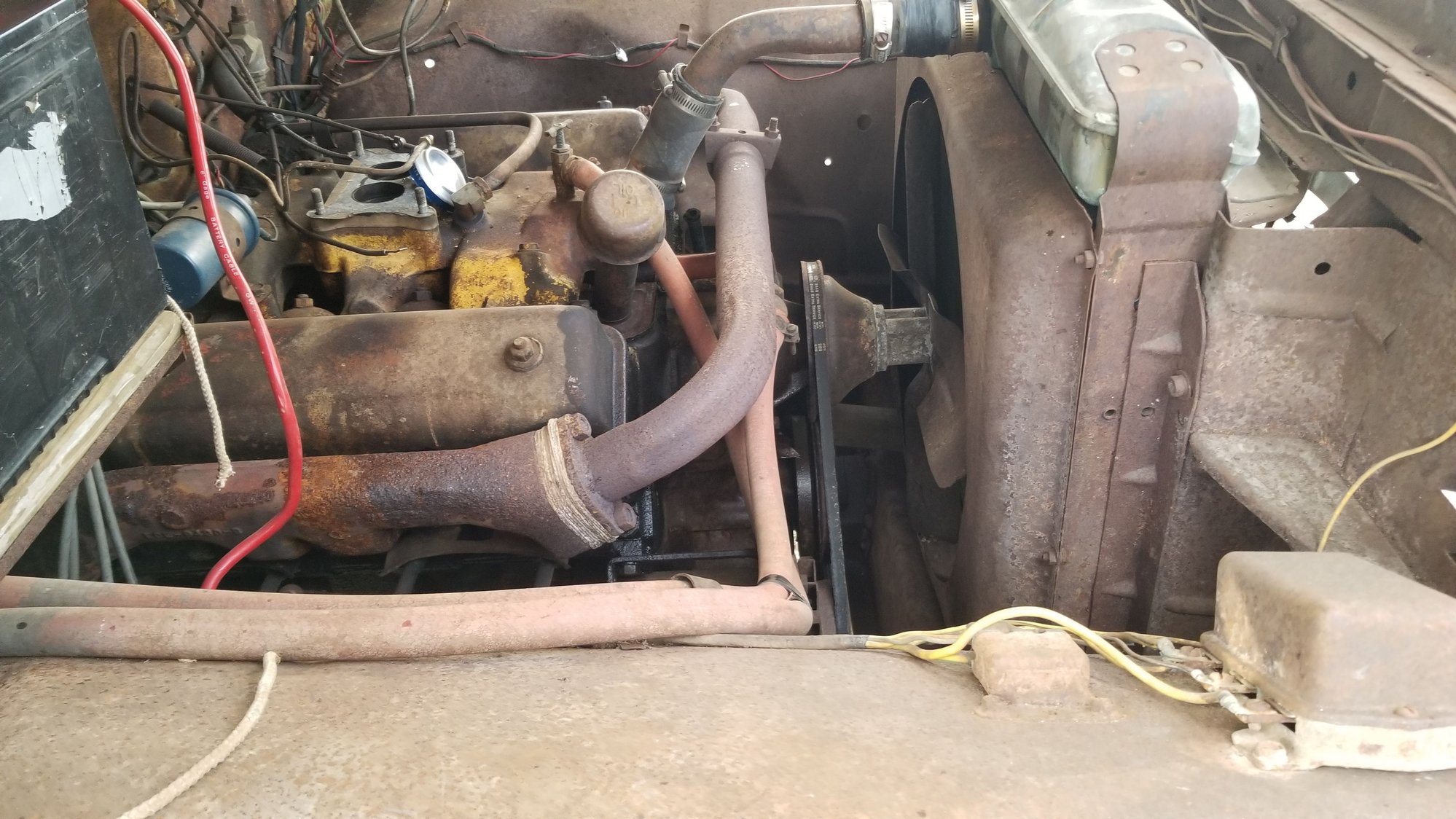

Passenger side view of engine. You can see the fuel pump, it looks newer than the rest of everything

Passenger fender view of the engine

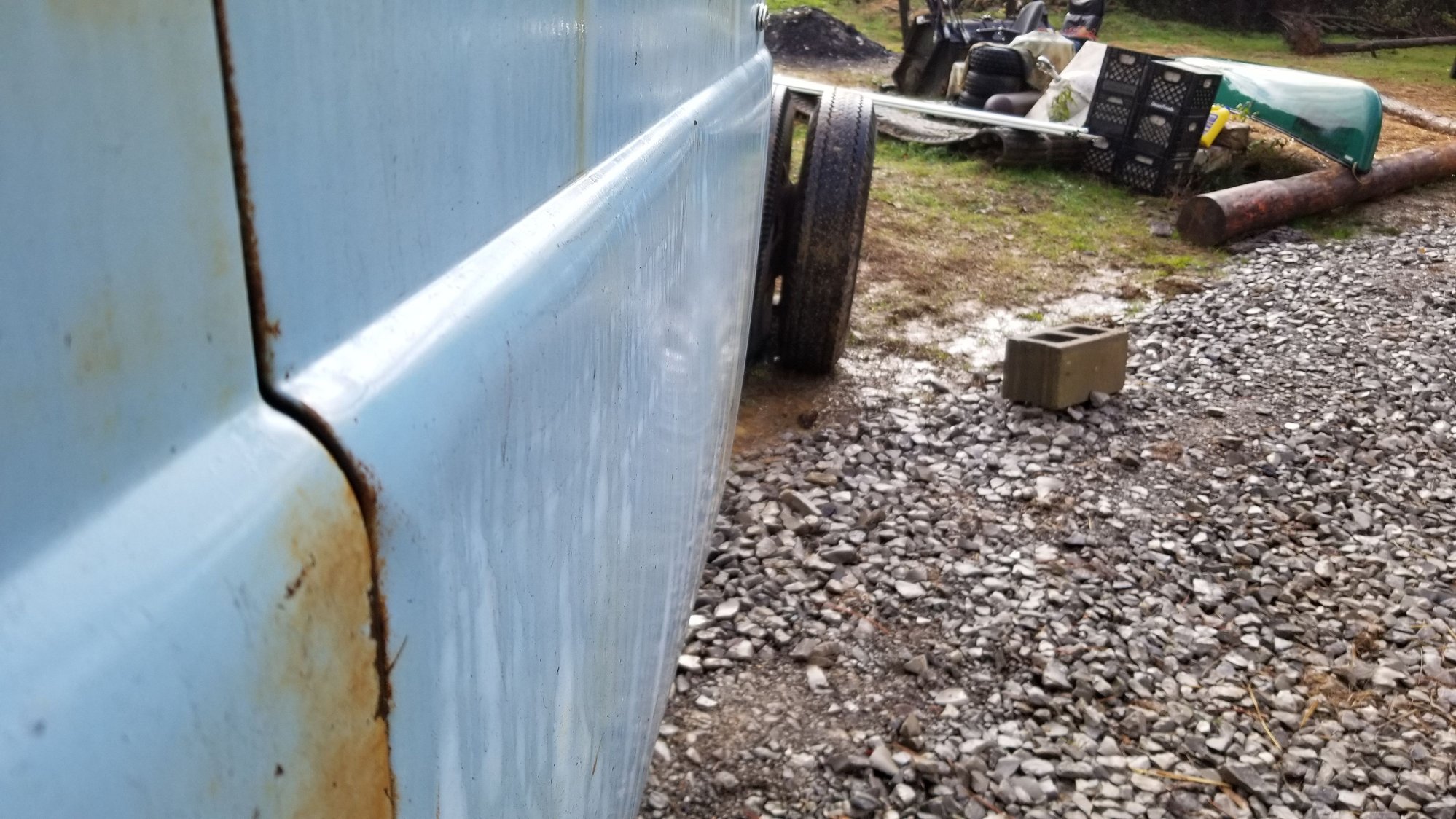

Now you can see the dent
Drivers side, you can't hardly see the dent in the door from this angle

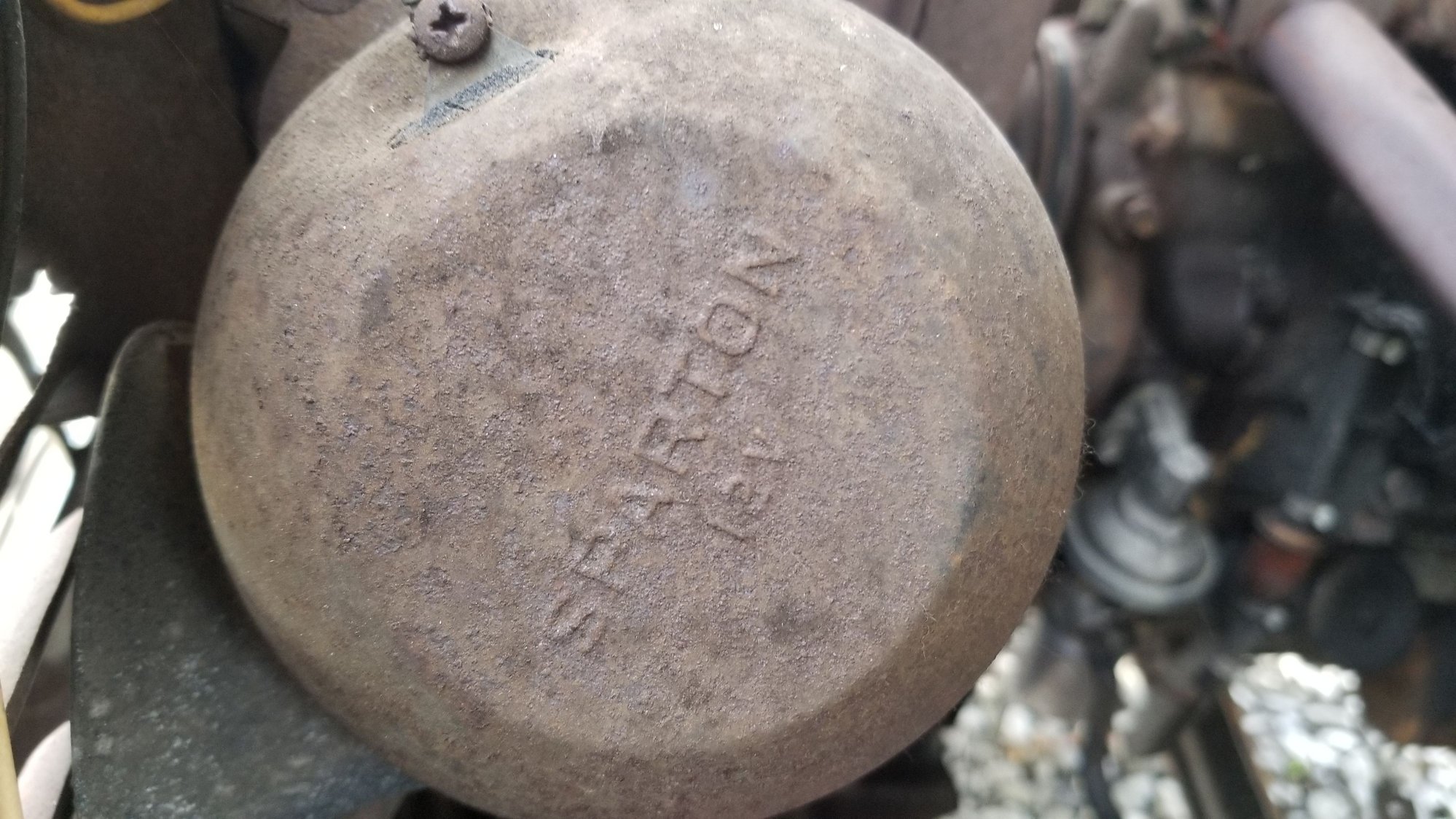

Drivers side horn

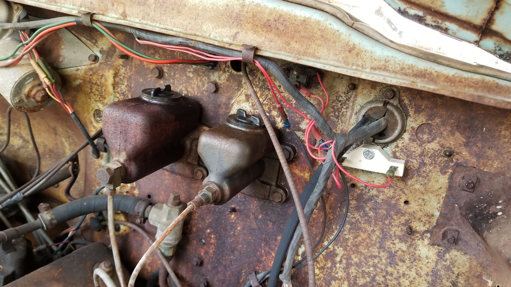

New brake master cylinder

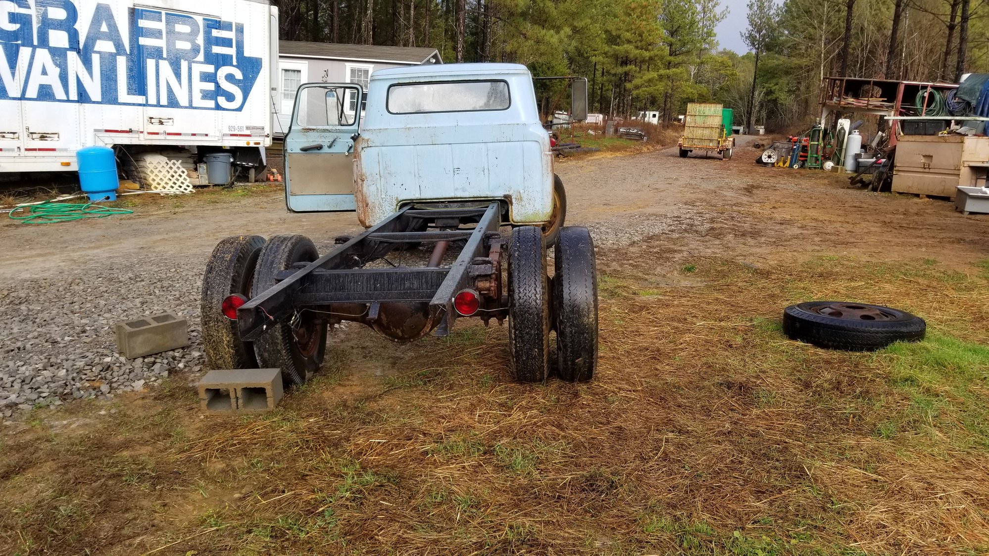

Driver rear

Spare on ground

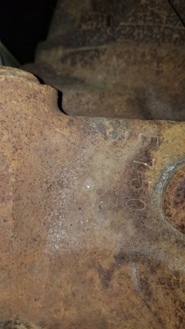

For doing the rear lugs, I'd also have a pork chop in case the inner lugs come loose while trying to loosen outer lugnuts. If you plan to haul 150+ miles a day, I hope your ready to do a lot of maintenance. Stopping is more important than going. Definetly replace the rubber lines. Have you taken a good look at the rear axle? The 2 ratios should be stamped on the flat of the differential by the shift motor. The 2 speed will really help. If you want to help your engine, get rid of the crossover pipe and make a dual exhaust. You can buy rams horns, but they can get pricey, unless you have deep pockets. Or you can take off the pipe, block the front access on the passenger side, and make a bend down from the left manifold and go back. Opening up the exhaust will definetly help your engine.

Anyway I get the carb on, fix the the turn signals/brake lights front and rear, probably have to run new wires entirely. Then I can drive down my gravel road a bit too see if it stops at all. If it stops at all I may start in on the brakes and see how well I can get them to work. I believe from researching about this particular system the booster may be my source of no brakes. I think the booster assembly can be rebuilt but an aftermarket may be in order just to get rolling.
If the brakes do nothing, I will inspect them to see how f-ed up they are, shouldn't be that bad PO said he put new wheel cylinders on, the old ones are in a box so I believe him on that. But I don't think he replaced the return springs hold down springs or wire brushed all surfaces and greased the appropriate places. So I'll see then if its "in the wheels" or if maybe its that 60 year old booster under the cab.
What it's doing now is the brake pedal will go to the floor without a whole lot of resistance. Now it doesn't just fall or stomp right to the floorboard it goes down like its actually pushing fluid but when you get to the end it doesn't rebound. I'll say the pedal comes back up but its not from the pressure in the system its the pedal spring. One thing is the truck was not running when i did this, two is it really felt like the brakes pushed out but didn't pull back together thats my reason for hoping its the springs.

These numbers here?
