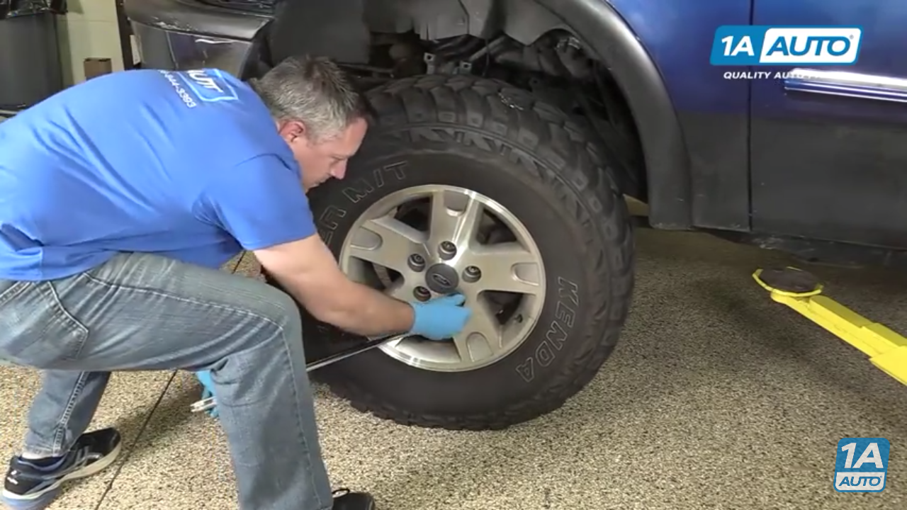

Needing Help Finding Rims
Found these looking at a repair guide. I need to find them

Came on 2002 and 2003 FX4 supercrew trucks I believe.

17" X 7.5" FX4 wheels
Rock Auto shows to have some in stock.
https://www.rockauto.com/en/catalog/...eel,wheel,7644

Would any other year model rims work?

97-03 F150
97-02 Expedition & Navigator
You haven't stated what year & model you want to put these on but if it isn't one of those listed above then it isn't going to be an exact fit.
Wheel lug pattern is 5 X 135mm.
Older F150s are 5 X 5.5".
135mm = 5.31496"
Newer F150s are 6 X 135".

97 f150. Would any newer model truck rims fit?

Read through this again:

6 ≠ 5
