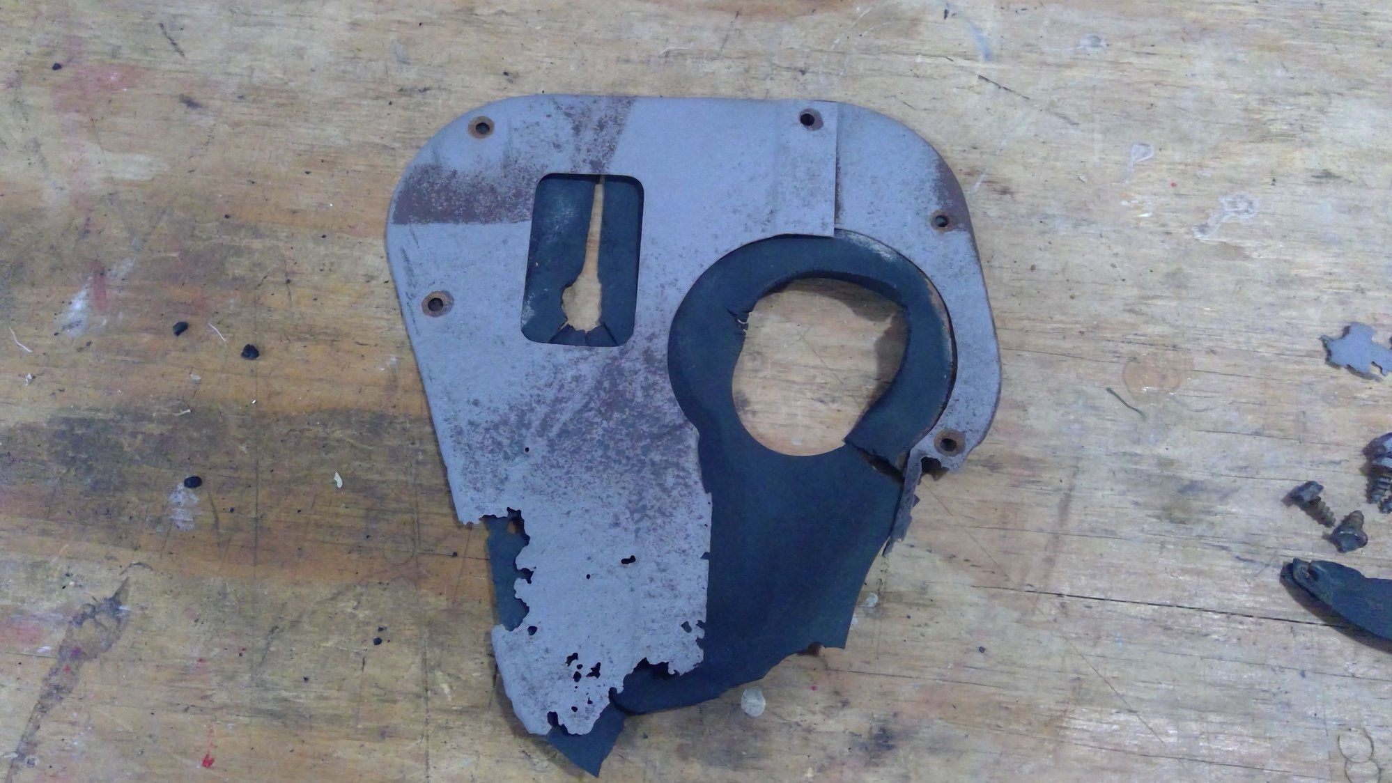

Pictures of Area/Part
Here are a couple pics; one where it goes and the other the part itself after removal.
Old Dec 1, 2018 | 01:38 PM
cosmofennema's Avatar
cosmofennema
Joined: Oct 2018
Posts: 368
Maybe it's just me, but I'd grab a piece of 18ga and a tin snips and cut me a new one in about the time it'd take me to say "first, the cardboard pattern.
Seriously, this is not a hard part to reproduce on your own.
Cosmo
Old Dec 1, 2018 | 04:08 PM
oldracerjones's Avatar
oldracerjones
Joined: Aug 2013
Posts: 284
From: Chico, TX
Manufacturing It Myself
Cosmo
I agree, my only concern is a rolled edge around the panel, looks like it just covers and holds the rubber sheet down. Flat edge should work just as well. Thanks for the idea.
