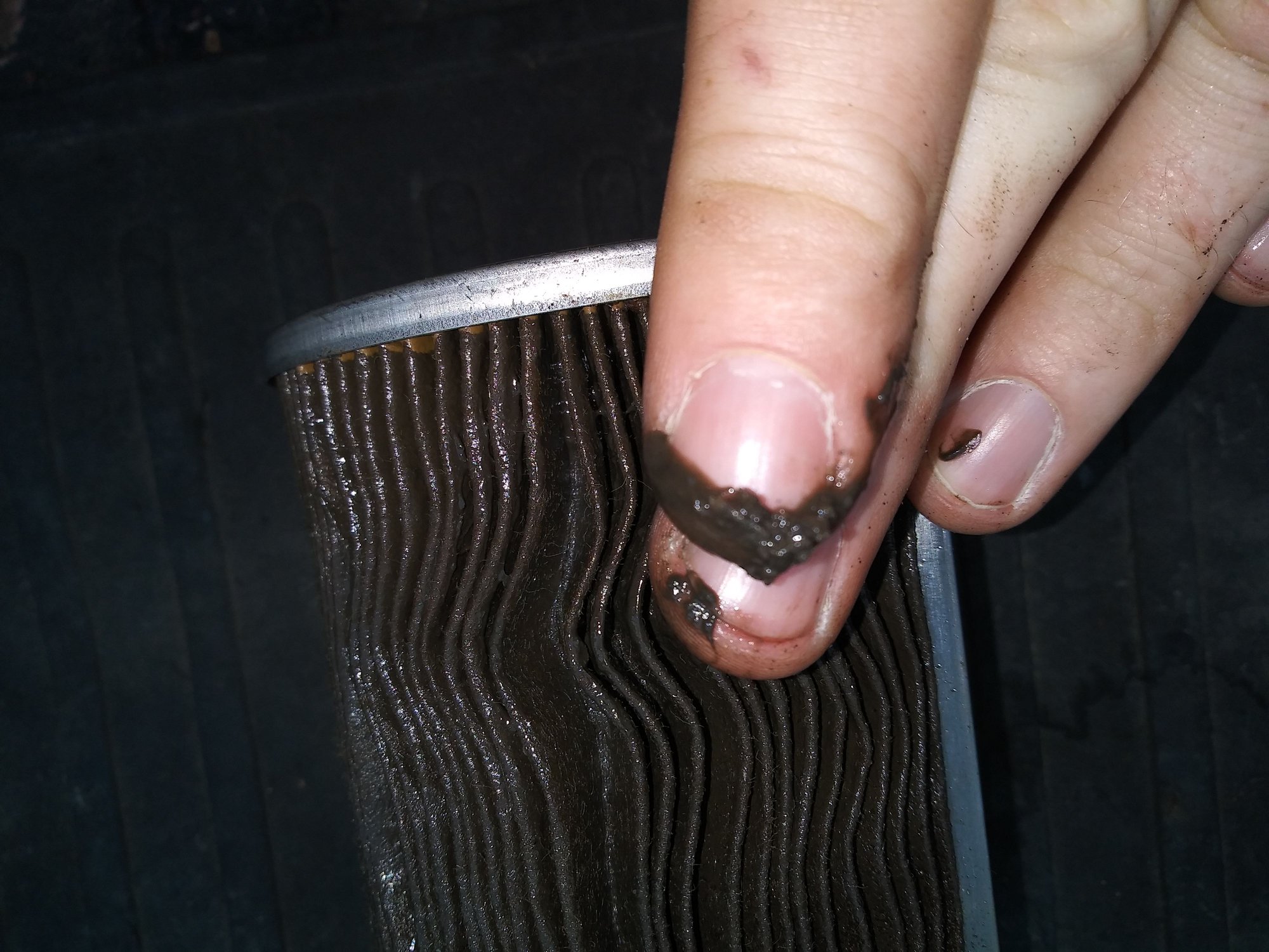

This is my filter at175K with only 3K on the filter. It was the first filter installed on this engine.
Wow that is pretty bad. I need to get a filter set up on my truck sooner than later.

[QUOTE=oldbird1965; This is my filter at175K with only 3K on the filter. It was the first filter installed on this engine.[/QUOTE]
DISGUSTING! I think its safe to say it was never changed/flushed before you got it.

Do not kid yourself. Here is my filter I just opened yesterday, one of the first things I did was flush my system and fill with 50/50 Fleetcharge and distilled. I ran this filter for one year, about 10k miles I guess.
It was flushed and changed 3K miles before I pulled the filter. It was a new filter that I put on.

That's incredible... Makes you wonder why auto's don't come with a coolant filter as standard equipment. When I took my old radiator & (Bad) fan clutch it was pretty gunky looking too & 255k miles I bet It would of done some damage to a filter. I'm glad I replaced the radiator but I'm sure my heater core etc has junk in it. It's amazing to think how in the world so much dirt get's inside the system but If you think about it...I think the coolant has the most miles if you think about the whole circulation through motor, water pump, hoses, radiator, more hoses, heater core, repeat lol

I've read that the crap in our cooling systems is from the factory's casting process when making the block. According to this theory, the block is not cleaned very much after it is cast, so a lot of the sand-like material is left to circulate in the cooling system when the engine is completed. It is also said that a coolant filter will do the most good when it is first put on, and that as the factory crap is gradually removed, the subsequent filters have less-and-less work to do. Money back guarantee on this information.

Also the casting process (sand) will eat up WP's.

Yes that sand is like sand paper with-out the paper. It will slowly tear away the seal on the pump shaft & then you will have a leak ,1st @ the weep hole. You may also start to smell the anti freeze after shutting down the engine . [After a hot drive]
