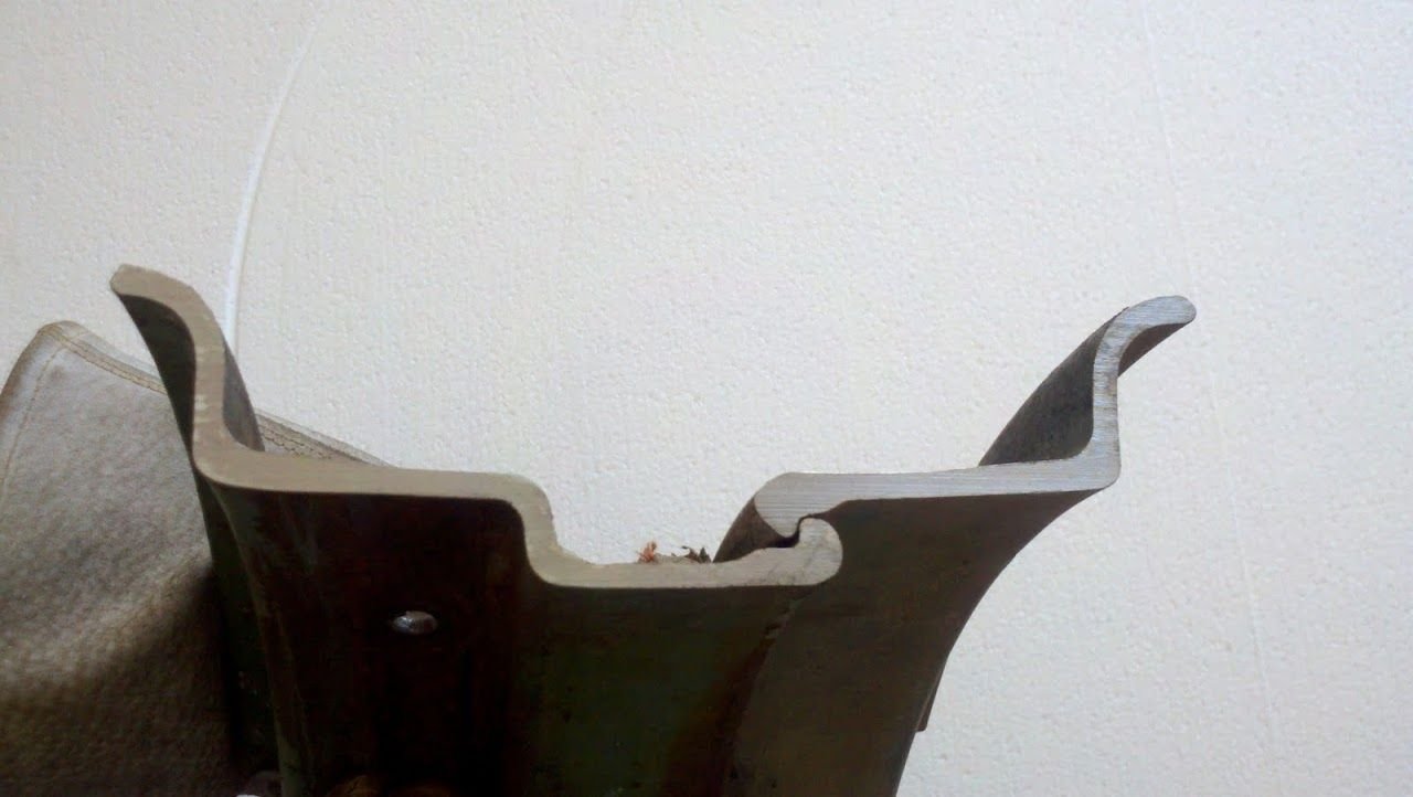

These are split locking ring rims. Split rims were the old Firestone RH5° (AKA widowmakers) that split the barrel of the rim. See below pic of a cutaway of the RH5° rim.
That split (crack ) in the ring on your rim is supposed to be there, that is how the ring is removed and the tire demounted. You'll notice just right of the split a notch in the ring against the rim , this is where a pry bar is inserted to lever the ring off the barrel of the rim.
Any competent tire shop will be able to work on these. If you are getting resistance find a shop that does at least medium duty trucks or farm/ construction equipment and they will do them as these style of rims are still used on most pieces of construction equipment..... these rims do require the use of an inner tube.
Really you would be ahead just finding a set of 16" one piece rims. They should be easily sourced from any you pull it wrecking yard..
But to answer your question yes you can still use what you have....

Yes they have to have tubes no matter what. Tubeless tires seal on the lip of the rim. Tubeless tires can't seal on the split locking ring cause of the split in the ring, not to mention the where the ring meets the barrel of the rim. All split locking ring rims have to use tubes.
Not to mention they are bitch to balance and usually end up with excessive amounts of counter weights.
In the long run you are better off finding a set of one piece rims. One piece rims will balance better and are significantly lighter and will lengthen the life of suspension/steering components.
I'm all for keeping stuff original but this is one area where modernization/ upgrading should be done...
