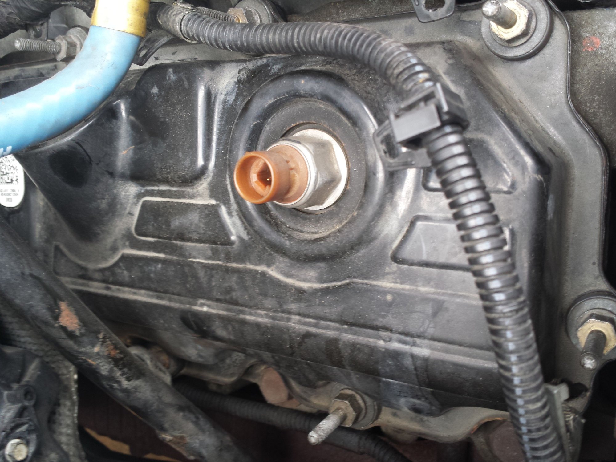

See if the ICP sensor is here on the passenger valve cover.

Posts: 5
this sensor is there. what does this mean and what do i do now

The sensor location just tells the rest of us which version of 2004 motor you have.
Multiple starters and the engine does not spin means you have to see if you can manually turn the crankshaft as Pete mentioned above. A starter that does not spin the crankshaft can mean one of the cylinders is flooded with fuel or coolant. So if that's the situation, no spin, you start pulling glow plugs and seeing which one has liquid escaping. If it's fuel then it's a bad fuel injector most likely. If it's coolant that comes out, then a coolant leak from either the EGR cooler or a head gasket.
