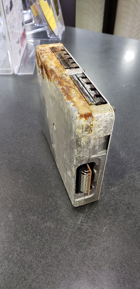

I asked the dealership and they told me they were unsure if it was the CPS because they were getting different codes. They also pulled my PCM and it has rust and what looked like water damage on the outer casing. Could that water damage have gotten into the PCM?

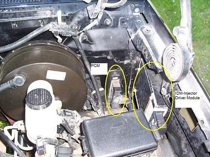

Did the pull they PCM or the IDM ?
PCM is in the firewall
IDM is mounted to the driver side fender

Please see attached photos of my PCM, I think??

[img]blob:https://www.ford-trucks.com/73204d87-4b3e-4d4b-9281-3a4fe22c8088[/img]

I don’t see pictures

Just got my truck back from dealership. Had them swap the CPS and it seems to run fine but has a wired idle when it just sits. Is that something I can adjust or do I need to take it back in? Below is a photo of my PCM.
Has anyone ever ordered from the company flagship1, I found one there for about $524.00!

You truck has a chip. I would pull the chip and clean the contacts and re-install

Your windshield is leaking
