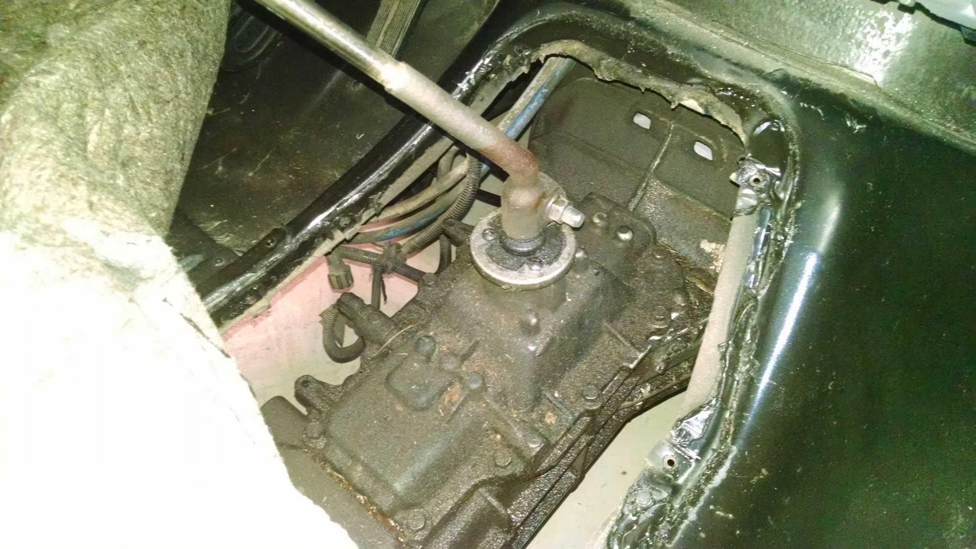

We may take it off later but if you can get the 10 bolt cover out with it on, leave it. There is a cover or pan over the transmission you remove first with screws and pry up because of the sealant around the mounting area, then you have access to the 10 bolt cover. If you have to take the shifter off take the shifter nut off and put the bolt on the opposite side and use the nut and turn it until it lets the shifter come out. You will have to remove the screws that surround the shift boot. There are four. Remember to have the shifter in neutral. Sandy

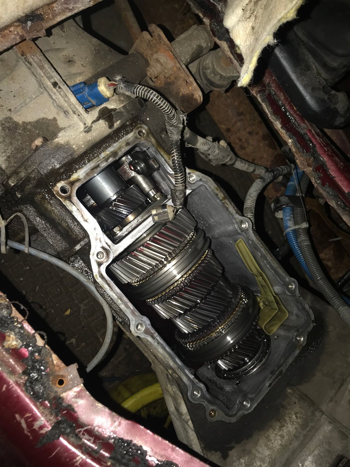

Here is a picture of the ten bolt cover after removing the pan cover. You can also see the shift bolt I referred to about the shifter removal. There is one electrical connection to unplug when you take the 10 bolt cover off. It is for your reverse lights. If you don't get the full picture, click the top of it and it should show everything.

Sorry I see what you mean now. I was unaware that under the carpet the floor could open up more.

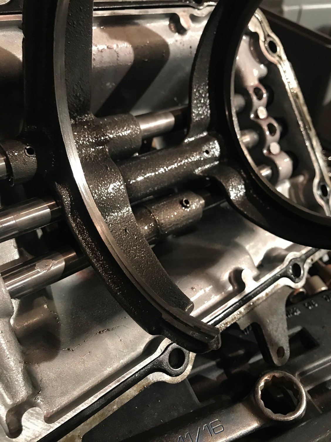

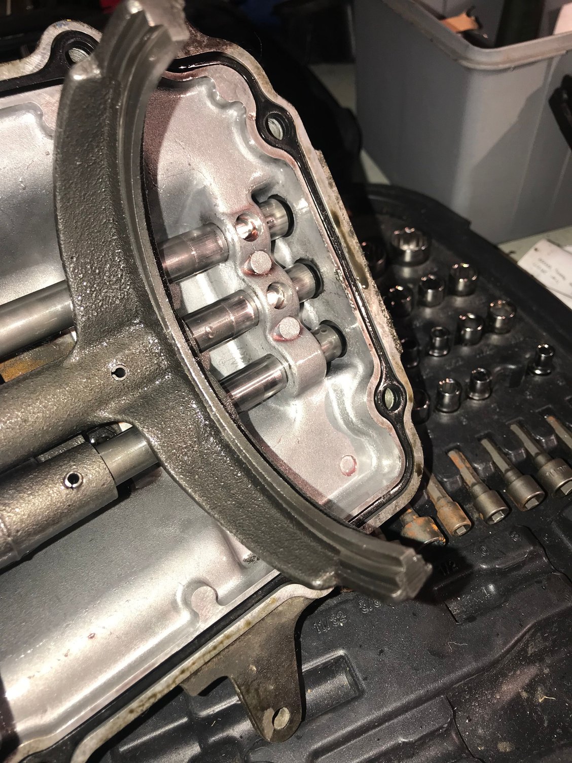

Was able to get it open. These forks look pretty worn. What do you guys think?

Below is a picture of a good one and a worn one. I would say from your pictures yours are worn. In the picture the fat part in the rail on the left is much thinner than the right one. The rails fit inside the two pieces in the transmission that are slotted. When they get thin and you shift they start sliding over the slotted area disengaging them. At least that is my understanding. Your most worn one is 1st and 2nd gear which is used more and the source of your issue. You need to replace both of them.
While you are ordering them, pull your shift lever off as I described above and check the shifter parts. I am posting a video of how to replace those parts and it is easy and very effective. I would be more sure about the installation of those parts than what the video shows. Should be available on youtube or from where you order them. My guess after seeing your pictures is those are the pieces you found in the fluid drain. I think they are under 20 bucks.
I would not attempt to remove the forks until you get the new forks so you can get it done while memory is fresh and the sequence makes sense. Let us know when you get them and we can give you some installation tips. There are some parts in the cover you need to be aware of and how to remove them. In the meantime, you might as well get a center punch for those shift forks also.
