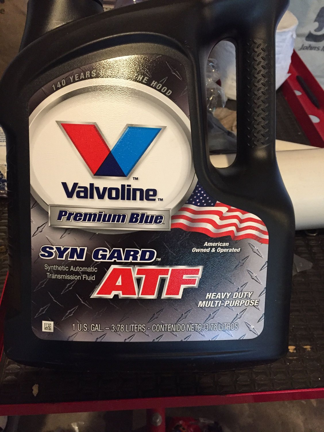

IIRC, there’s an oring on the high pressure side. I bled the system when I replaced the pump and put synthetic fluid in the system.
