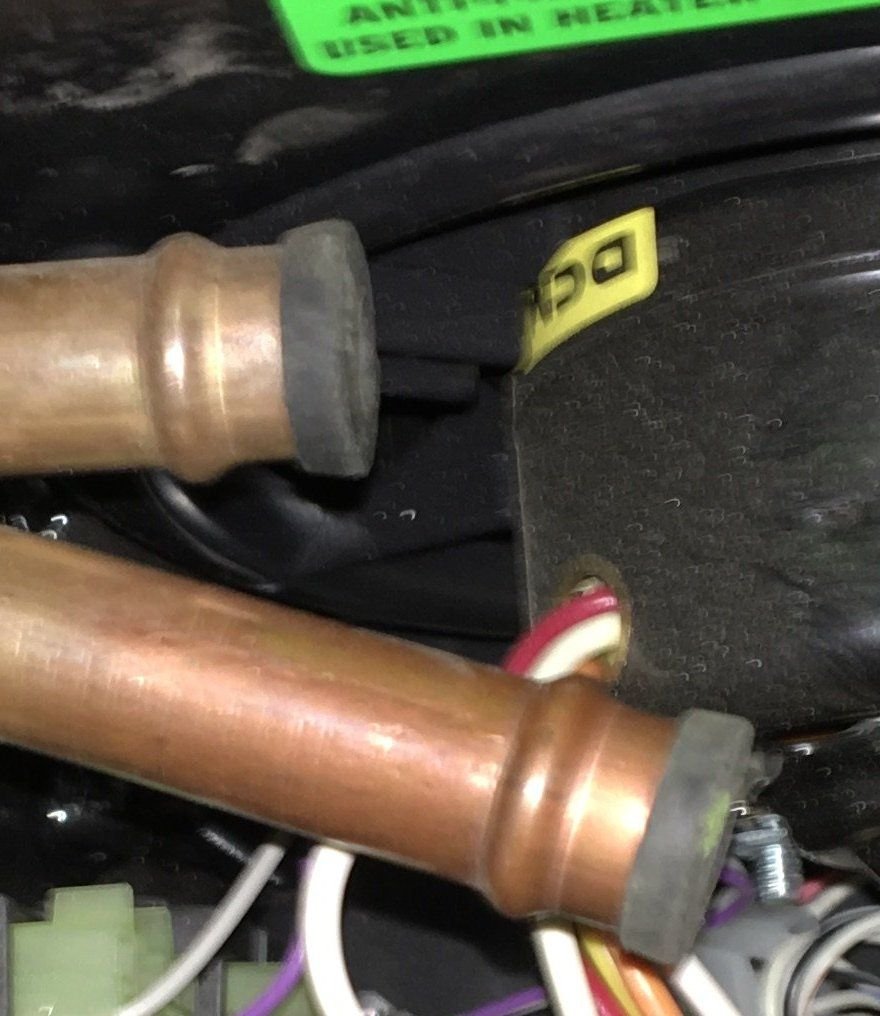

thought I posted this last nite but no sign of it ... I'm looking for a 'tool' that can make "bubble" flares in the
body of tubing, not on the ends.. to make a stop for the screw clamp to hold against... something
like this. Any ideas or anyone know how these are made ??? Looks almost like something was inserted
into the tube then expanded somehow... then 'despanded' and removed... Material will be 1/2-5/8" alum tube.
john

Google metal tubing beading tool. You might also try calling local radiator shops to see if they have some if you only need a few done.

I've overthunk this one before, too. I found that you can make too big of a hump and create a problem with the hose not fitting over the tubing well, and creating a high spot which can lead to hose failure. My solution was to utilize the first step of a double flare tubing bender just slightly, enough to create a lip and hold the clamp from sliding off, but not so large that you struggle with pushing the hose past it.

I have had success using the push connect dies with my dads flare tool, but only compressing it slightly to get a ridge rather than all the way to get the large lip.

I just had a thought (did you see the smoke? ) Why not use a brass compression ferrule and sweat it on the tube? I suppose it you were industrious enough you could even file off the ramp on one side and make it into a barb or even do several for multiple barbs. Or... you could use the compression fitting whole, tighten it down so the ferrule crimps on then cut the nut off from the tube.

hey Ed, well, that's what Vintage Air did and yes it's just to give the clamp a stop. I'm having trouble finding a beading tool for 5/8" tubing that isn't too expensive for the project. I'd hate to spend 60 bucks + shipping for a tool I'll use maybe 4 times.
Beav... that compression ring might be workable... I'll look into that, thanks.
