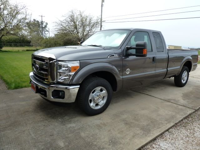

Changing the subject a little bit, I consider any FE a toy not a daily work horse. If you want a pickup to pull a trailer or fifth wheel then buy a newer F250 or F350 Power Stroke Diesel. Our 2012 F250 PSD gets 22 mpg average empty and 13.8 mpg pulling our 5th wheel along with 400 hp and 800 torque. Even our 511 ci. FE only has 713 ft.lbs. torque.

The 7.3 diesel is a very good engine, although Ford hit a home run with the 6.7
I am not sure what a good used 2011 F250 or F350 with the 6.7 would cost, but I am sure the smiles would make up for any extra costs. The torque is unbelievable. I know the 2019's are at 900 plus, ft. lbs. torque, but 800 is plenty.
All I was pointing out is that for a daily hauler pickup, you are hard pressed to beat the 6.7 which again has more power and better fuel economy than our beloved FE's
We all have favorites, mine is the 1972-74 F250. with a 428 or 445. Again this would "for me" be a toy, not a work truck. Add to that the comfort, of the newer trucks, and it is a win, win, situation. Power, mpg, comfort, style, Ford got it right again.
