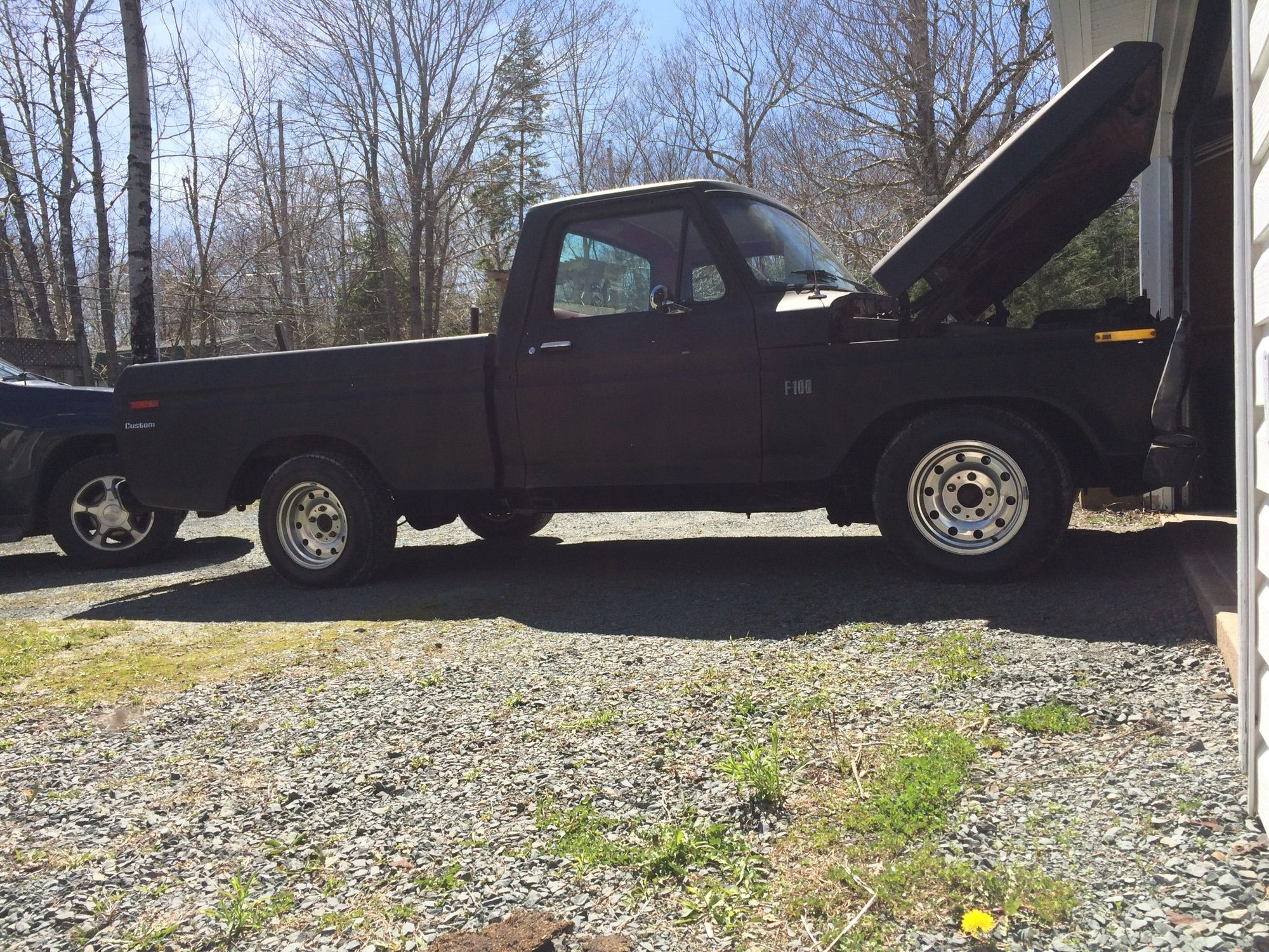

Mine at its lowest
Did the drop beams and hanger/shackle kit from djm, pretty good stuff. You are right that it didn’t lower the rear much. I took some leafs out and used the higher hole on the shackle and got it better. Unfortunately more than 300lbs in the rear and it sat on the bump stops. A flip kit and c notch would be good but most require cutting the bed, and the fab work on the c notch is no joke and you’re compromising the frame integrity unless you know what you’re doing
