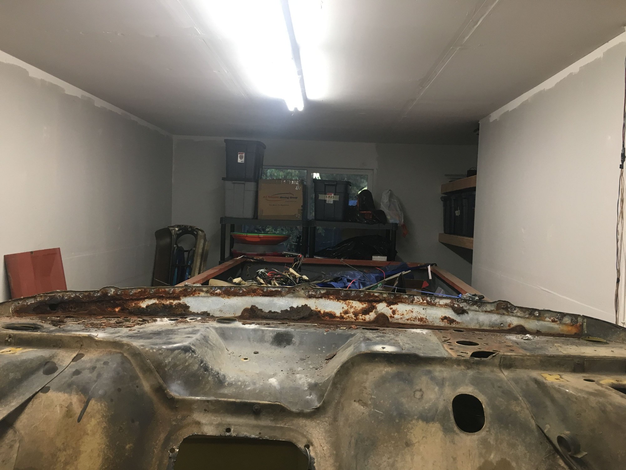

Firewall rust repair
Looking for recommendations or feedback on this repair... my plan is basically to cut out the bad spots and graft in some new material. Anything I should consider?
yes the cab is on its back.

I did an extensive repair on my build. You can see it on the build thread below. The repair starts on post #120 on page 8. Let me know if I can answer any specific questions. The only thing I'd change is that I'd make the top piece on my shrinker/stretcher, but I didn't have one at the time.

Thanks for all that. I think the sealant does more harm than good. My guess is it’s letting water puddle in there. I might reseal mine on the forward side of the firewall when done so if water does get in it can simply drain.
I hadn’t taken of the bad parts out yet so and assumed the firewall was tacked to the cowl. It helps knowing the dash is sandwiched in there. I will post more pics as this progresses.
