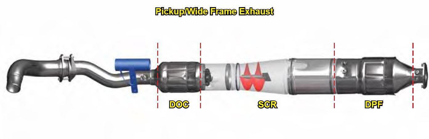

EGT11 is after the down pipe (pre DOC) and EGT14 is post DPF. The truck will take care of itself but those are the two I consider important.

Those are my favorites as well. I monitor EGT11 for engine heat while towing and EGT14 for possible passive regens (600+ with Enerburn, 700+ without).

Thanks. So if I'm only monitoring one to keep track of engine performance/load, it seems like EGT1 would be the one to look at, right?

Correct, EGT1 is the closest you'll get to engine temps. I don't know what the cool down is over that distance post turbo, I've always added 100°F. It's probably more.

EGT4 (14, post DPF) will be around 1,150°F about 5 minutes into an active regeneration. Towing I've seen it above 1,200°F a few times over the years during an AR.
