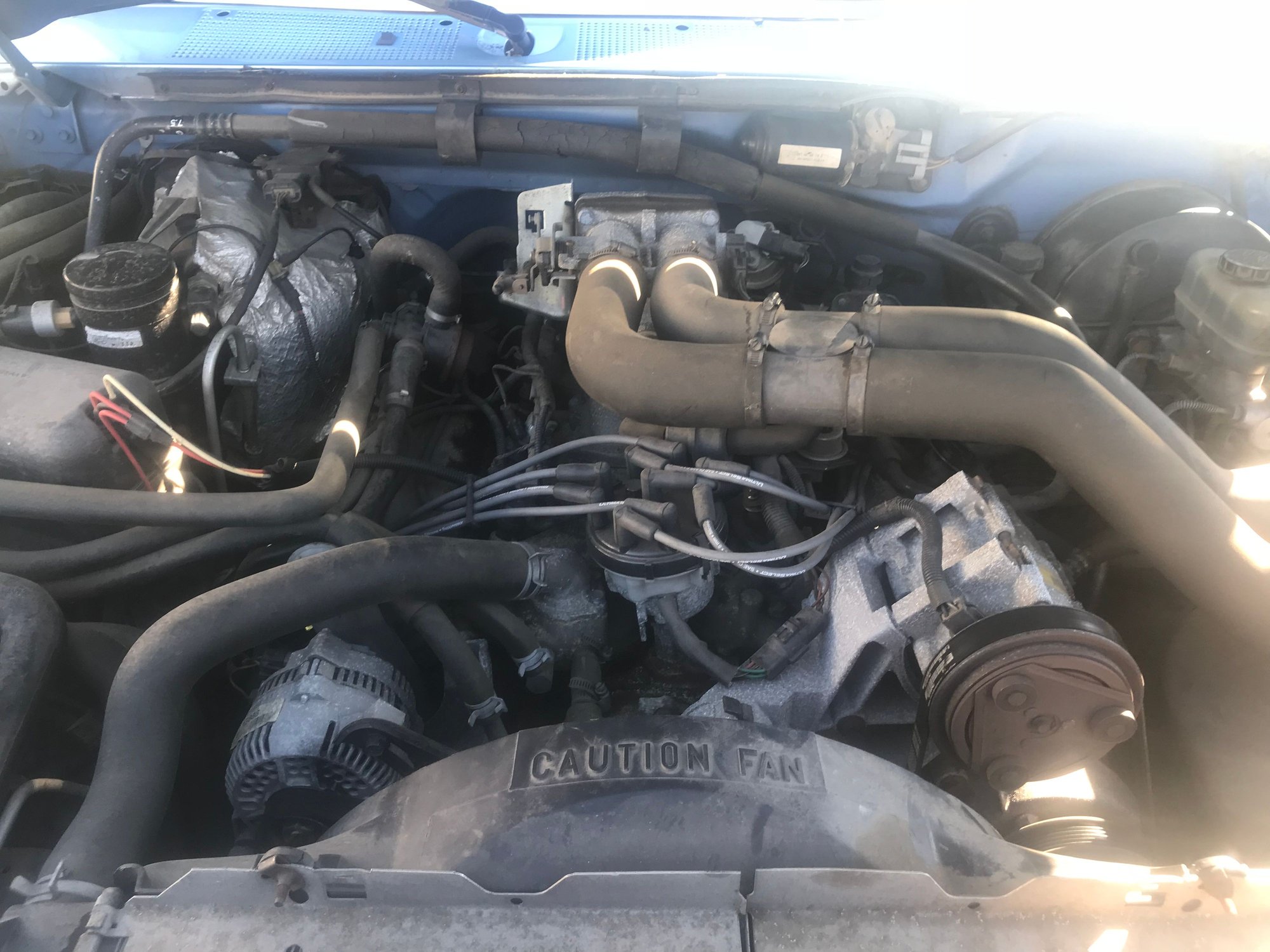

Yes, that is a 7.5L gas engine in your truck. The photos confirm the sticker under the hood for belt routing is correct for the truck.
Next question is why are you asking about the ACT sensor location?

I have a 1995 F350 5.3L V8 and I am trying to locate the air charge temperature sensor
Any help would be appreciated
The 5.3L is a General Motors engine. It is one engine in the LS engine family.
Originally Posted by ArieArie
I am not 100% sure if that is my engine how would I check? I have been told by some folks that it is 5.8 I never actually now how to find out
How long have you had this truck and not known what engine is in it? The horizontal intake tube configuration is a dead giveaway that it is a 7.5L (460)
