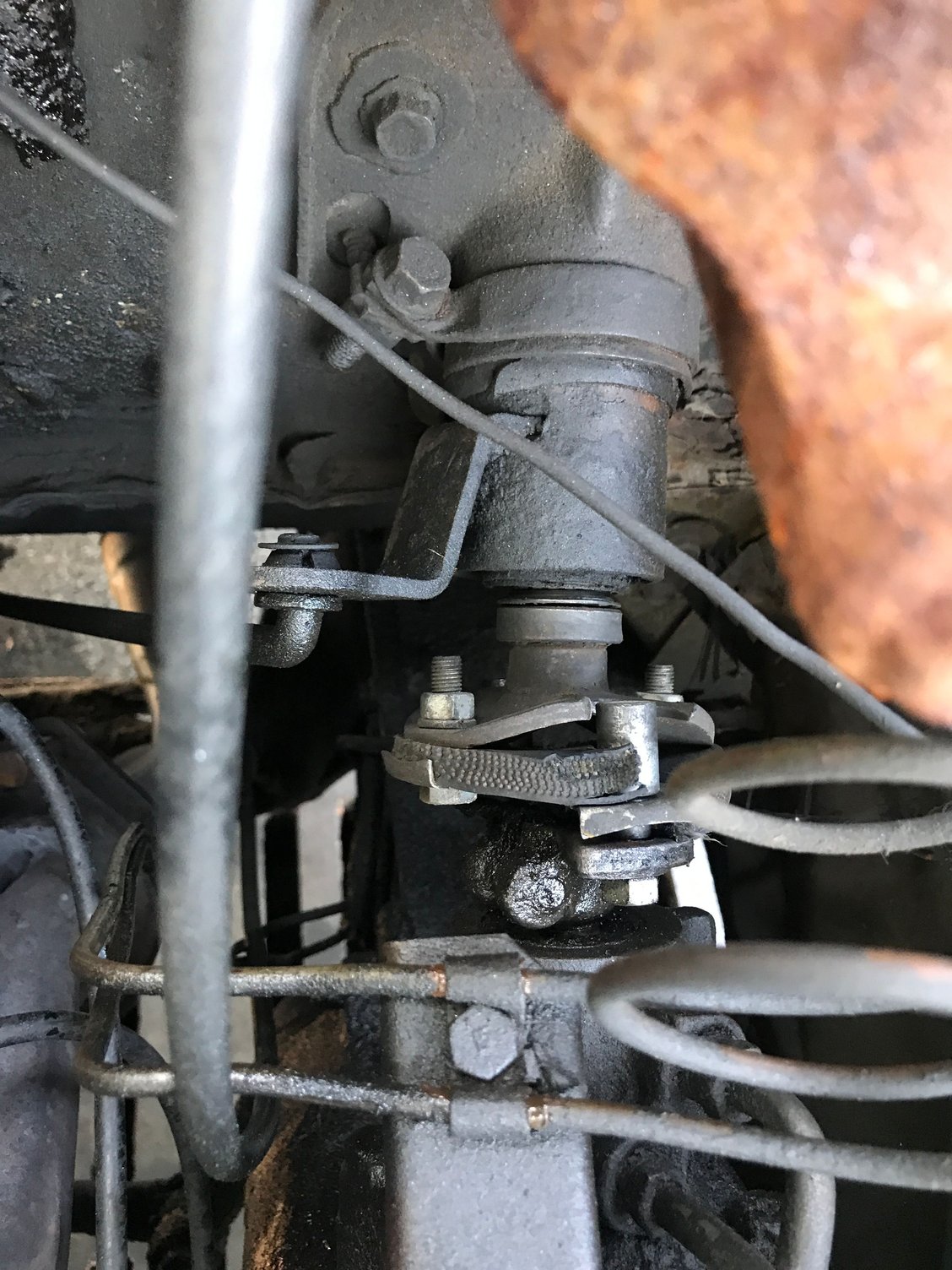

Let me load up some pictures in case I am wrong about my assumption that both ends are 36 spline

would you mind taking a look at the three pics above and tell me if you think based on what you see if I’m a 3/4x36 spine on both ends. Thanks

I don't see how you are going to run a steering shaft on a 2wd there is no room. Fix your dang cab mounts and fix your problem.

Not saying I've tried it because I haven't. I own no less than 4 2wd trucks; 2 bumps and 2 dents. I have recently replaced the rag joint in my '77 with the dorman one.
what I'm saying is; you are talking of replacing a 3/8" thick disc with a u-joint that is at least an inch long. I dont see how unless you scoot the steering column way up into your chest. There just isnt room.
sure 4wd guys run them but they have an actual steering shaft unlike 2wd where the column mounts right to the box!

Both sides of the rag joint get removed, not just the disc. The borgenson joint is 3 3/4” long. These joints are designed for this application.

I don’t have a 2wd so I may be wrong but the lower bearing retainer on the steering shaft looks loose. Looks like it slid all the way down. Does the steering shaft have lots of side play? The rag joint may be the only thing locating the lower end of the steering shaft.
Also.... The Borgeson style joint is not the greatest design for a street vehicle even under ideal conditions. It is only held in place by a set screw. You’re obviously getting some sort of unwanted movement at that rag joint and replacing it with a solid link seems like a bad idea. Especially if that solid link is really only held in place by a set screw.
