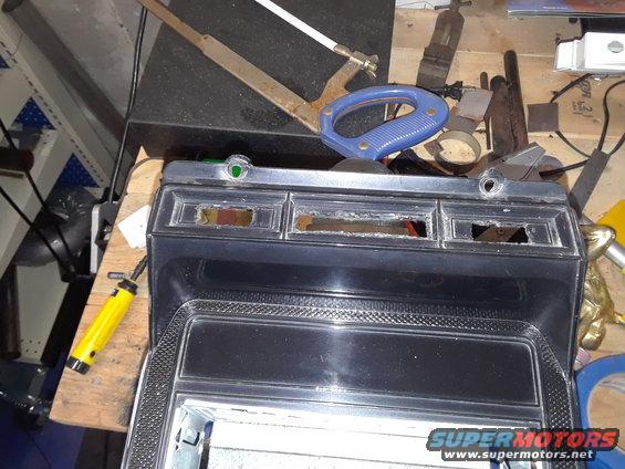

so, I’m yanking stock am radio out, and dash pad had such huge hole above it, I slightly enlarged and lifted out the dash speaker after unbolting the 4 Phillips with shorty Phillips driver. Want to install new dash speaker and door speakers and a modern head unit (already have newer jvc from different truck). To fit modern unit in similar spot to old, I’d have to reinforce and cutout different shape thinner and wider, and of course without **** cutouts.
So, I’m seeing if anyone went that direction, like epoxying a piece of 1/4” thick plastic onto front and back of area stock radio was in, and recutting to fit modern style head unit. I think I’ll bend some metal pieces to bolt to the lower dash frame where the old head unit slid in and out? So, the exposed part of modern unit is seen, but not structurally supported by plastic of the radio fascia. The structural support will be metal pieces fastened to stock metal lower dash, as mentioned.
OR!,,,is there a better way, hanging a newer unit below dash around ashtray area, or ? Like to see what your recourse was in fitting newer head unit into older dash and retaining stock plastic radio and hvac fascia.

Something like a radio delete plate, but need to recut for modern stereo head unit thinner and wider rectangular profile.

I’m leaning toward electric bass guitar black uncut plastic picguard material that’s 1/4” thick, epoxied to front and back of stock ford radio fascia, then cutting that out with jigsaw to fit modern unit. But I’ll have to wait for delivery. Looking around shop now cause I wanted to knock out most of it this weekend. Needs to be black plastic to blend in on front side.

I found a piece of quarter inch thick black plastic acrylic I’d ordered but forgot I had. Cut it to fit from backside and it’s curing with SEam sealer and a weight on it. Then I’ll cut and seal another plate n front and make my short wide rectangle for modern unit.

Yes. And I have SEam sealed a thick piece of black plastic to back side, gonna do similar on front and recut for the short and wide jvc head unit I have. So, I lose my round holes for old am radio, and have modern opening.
Stock had a metal clip on bottom of radio. It was not hooked to anything at back the clip at the bottom pulls straight out intact on the radio. You just pull hard. I moved that clip from my stock am to another stock am/fm and cassette. Was gonna do that but decided I like my cds too much. Not much on fm I want to hear either. So, I have to move to modern size hole and I’ll rig a fastening means to the lower dash frame which is what the stock clip slid into. On to my door panel and speaker figurin

Mine came to me with an old aftermarket radio. But I swapped it for a newer one. Hole was there already. No extra backing or additional plates.
This ain't the best pic but it's what I have.
BTW epoxy doesn't hold well on this plastic. It needs to really be scratched up to stick. I'm talking about going at it with an awl or sharp pic and like 40 grit sandpaper.
I did significant work with these panels when doing the gauges. Mechanical attachment is the way to go. The po put switches in the top row of holes (clock area). I had a booger of a time getting my filler patches to stick. Ended up having to use jb weld and mushroom it through the hole, so there was no way of it popping out. The plastic is real brittle too.
on a side note, mothers mag and aluminum polish will bring out a really nice dark black on the plastic trim pieces when buffed.
