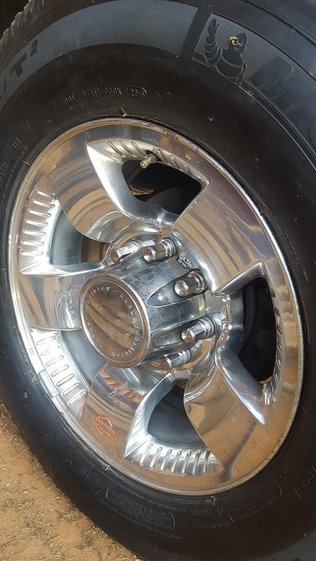

I finally found a set of harley wheels for my Ex but the lug nuts are missing. Anyone know if the newer (2016 up) lug nuts will work? There are a few sets on ebay but I can't find the specs on them.

2004. Didn't think about that. Main concern is the depth of newer lug nuts. I think the Ex has shorter studs than the trucks of the same years.

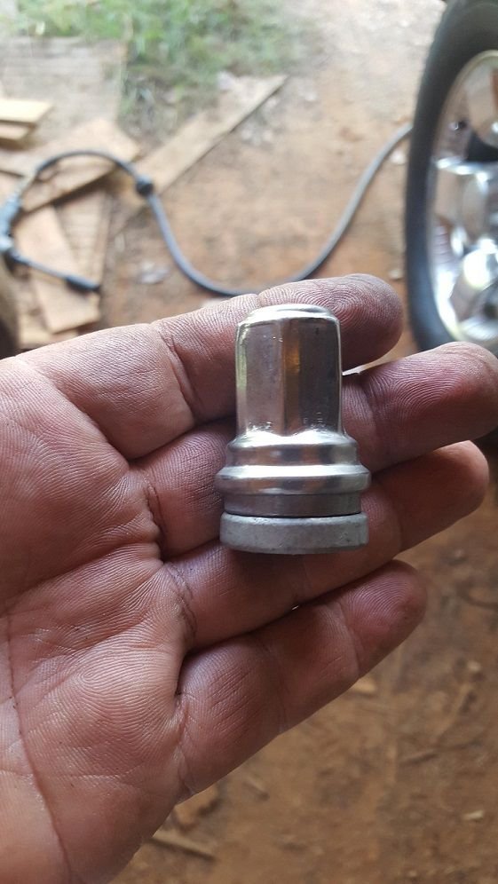

Just a follow up. I got a set of 2017 lug nuts from Ebay and they work great. I was concerned about the length being too short but the new style lug nuts are 1 7/8" long which is enough for the Ex.
