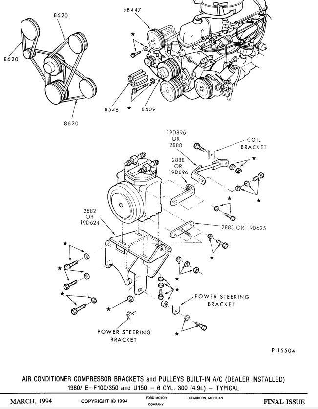

I bet it's supposed to have only one belt, if you look closely I am thinking one of those grooves in the crank pulley is just slightly larger diameter than the other, probably why it was making so much noise. One belt was trying to turn everything faster than the other belt was.
1983 F100/350 & Bronco 300 I-6
2) C9PZ-8620-GM .. Alternator Belt - 42.00" x 15/32" wide - Use with dual belt 40 & 60 amp alternators without A/C (Motorcraft JB-420).
2) C9PZ-8620-GK .. Alternator Belt - 43.00" x 15/32" wide - Use with dual belt 70 & 100 amp alternators without A/C (Motorcraft JB-430).
With A/C, these trucks have single belt alternators.
Pic: What is says:
