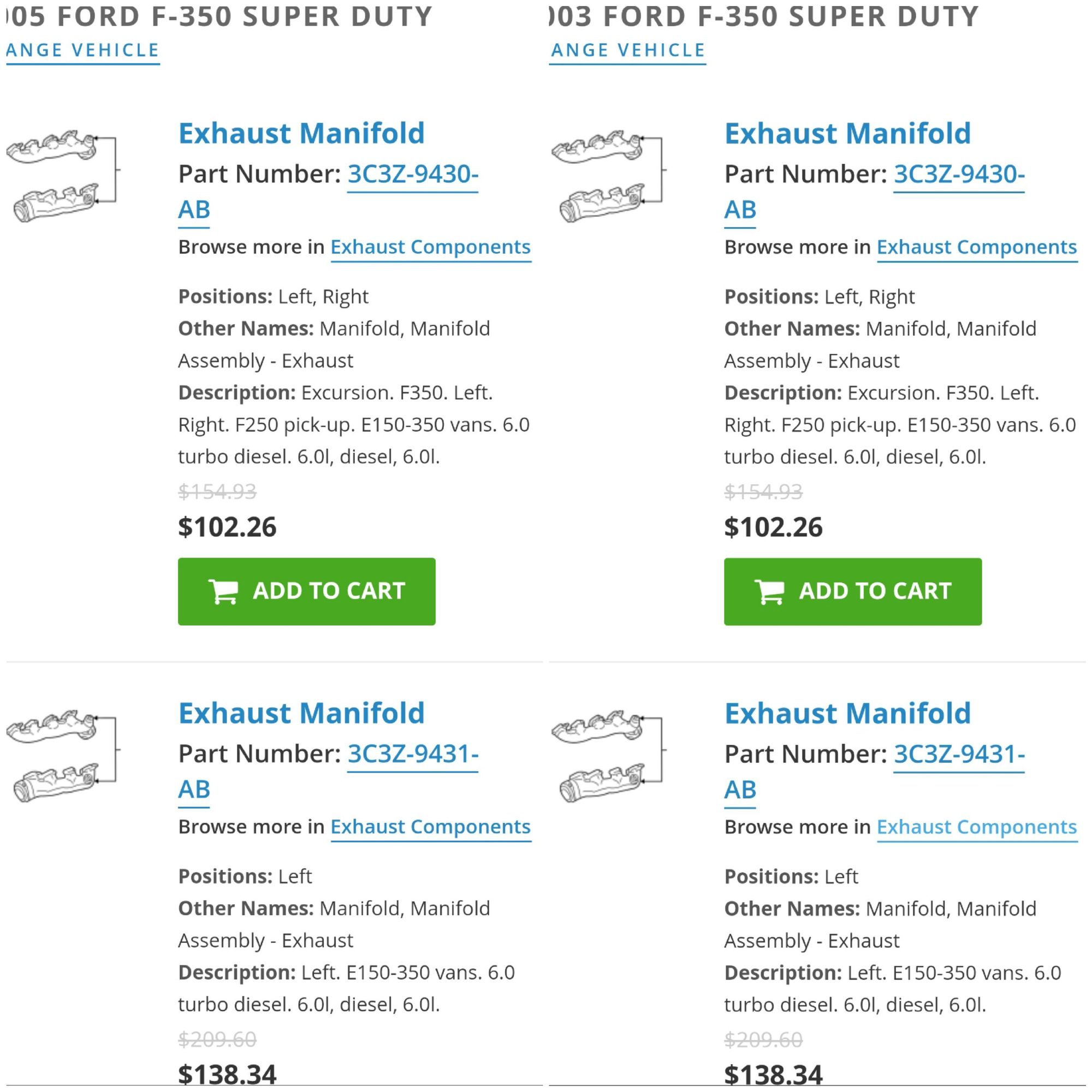

Hi,
The passenger side exhaust manifold on my 2003 CCSB has developed some holes in it. Are all of the 6.0 manifolds the same as my brother has a 2005 parts truck with a good manifold and he says I can have it if it fits.

Should be the same for 03 all the way through the 2010 e series

Yes, same.
left is 2005 right is 2003
