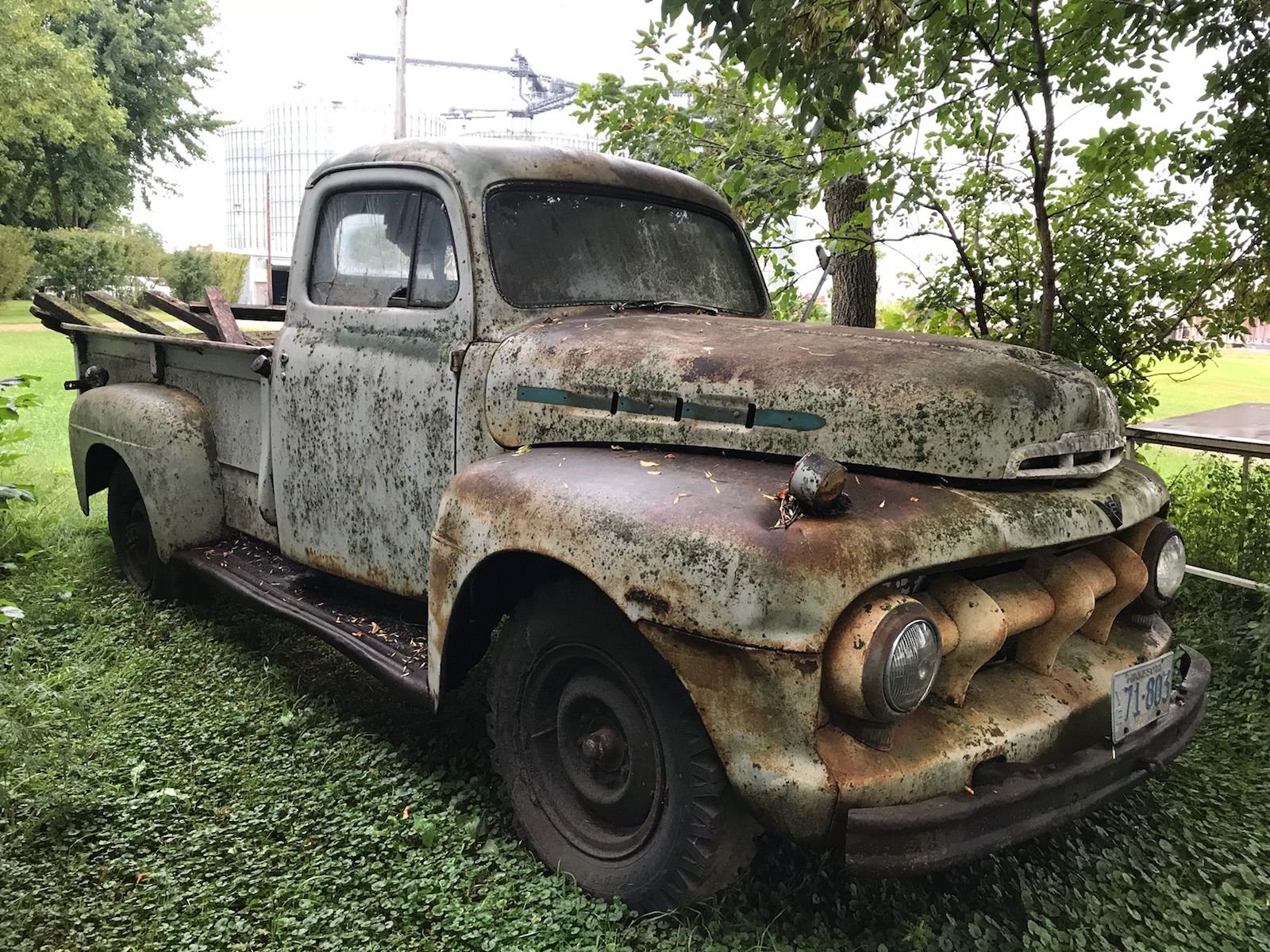

Add my welcome. Where is the emergency brake handle? If it’s in the left footwell it’s an early truck, or right of the shifter for a late 1951 truck. The early trucks feature the 14” Lockheed rear drums that necessitated the 17” widow maker wheels. You’ll want to do some Google search time on the “widow maker” and “Firestone RH-5°” terms. Your prior owner already replaced your left front wheel with one from a Chevy/GMC. That one is safer than the others but won't fit your rear hubs. Stu
