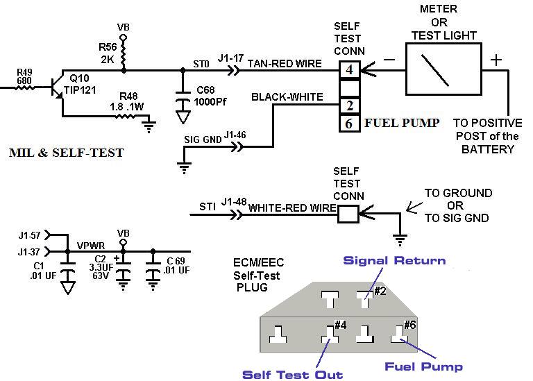

Also, might it be possible that I damaged it by grounding the self-test output instead of the input? I was trying to do a KOEO test by memory and instead of running a jumper from the STI to the ground terminal, I ran a wire from the STO terminal to the ground. Maybe just coincidence, but now the motor won't run.

Grounding the STO pin should not have heart anything. Putting power on it might.
Attachment 281523
When you turn the key to the run position does the MIL come on in the cluster?
