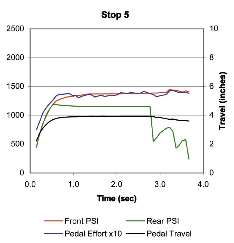

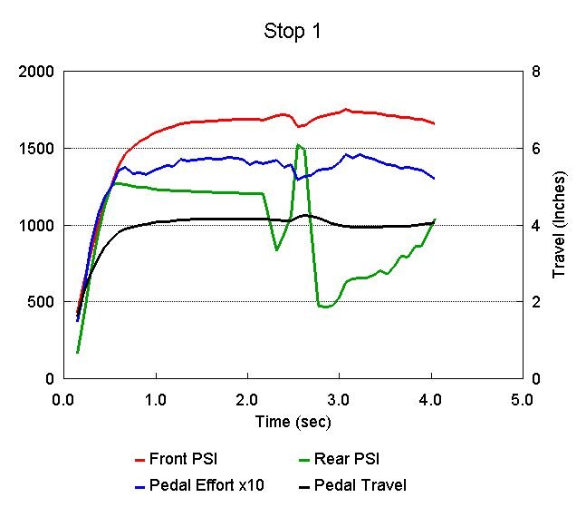

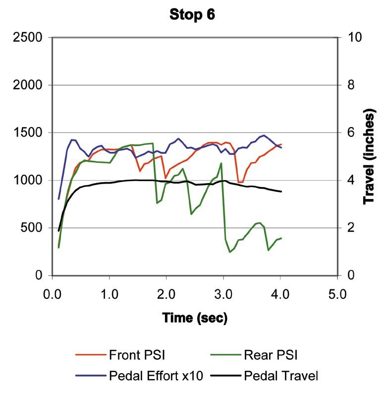

With standard ABS I'll show some stop data. The graphs are different because of coming from different tests, but they are good examples. All of these are best effort stopping distance GVW 60mph with a target of not to exceed 150lbs pedal effort.
In this first one the vehicle senses a rear brake condition where it should proportion down the rear pressure to avoid an impending rear wheel skid. It does that from 0.5 to 2.1 seconds. At that point a rear skid happens anyway, the ABS closes the rear valve and dumps to the accumulator. It releases, the ABS pump re-pressurizes to get close to the driver applied pressure without proportioning. Skid happens so it repeats going deeper and then having learned slowly brings the rear pressure back up.
Next stop. Not as an aggressive rear skid trait, but still happen later in the stop. Rear brake proportioning was applied at 0.5 seconds. Neither of the two stops had any front activity.
The third stop has both front and rear wheel skid tendencies. You can see the proportioning to the rear channel, but not to the front. the front is working off ABS activity, no proportioning.
I uploaded all that since that was your questioning. But I guess I missed that your truck has AdvanceTrac. That's a whole other ballgame which takes into account other aspects of vehicle control. I was out of the game before that was in production but what you're seeing could be a fault within that system. Typically when AdvanceTrac goes off there are other aspects to look into, and for that you need dealer instrumentation. It's not just simple foundation brake issues.
