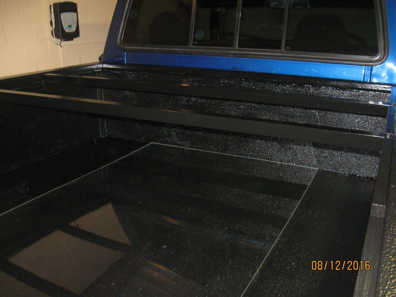

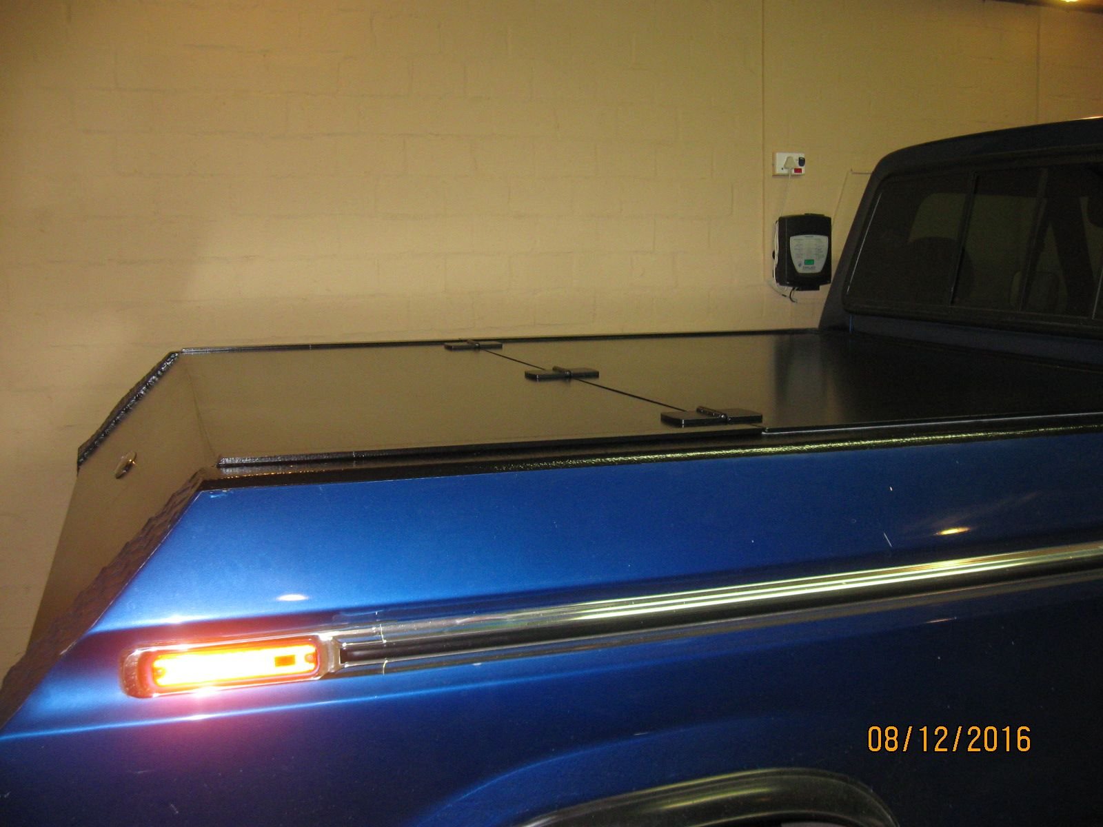

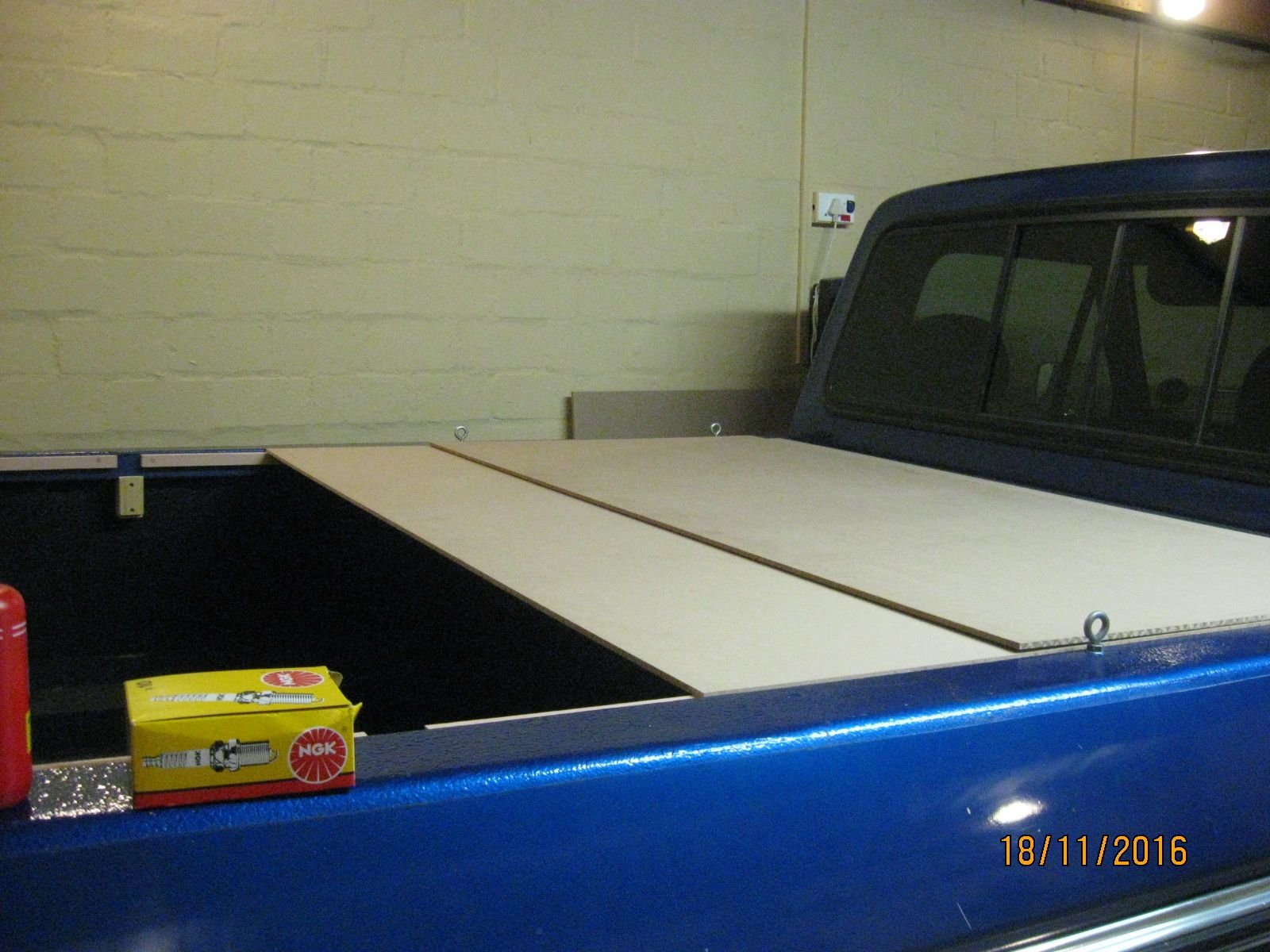

I built a cover using 1/2'' marine ply in two halves.
They are primed and painted black to resemble a typical vinyl cover.
The front half is bolted down with 4 bolts, and the rear half is attached to it with hinges.
Weatherproofing sponge/foam strips keep the underneath 100% dry.
Ally cross beams provide support for the covers. The covers can be walked on or have things loaded on top of them.
I subsequently fitted gas struts which can be removed easily if required.

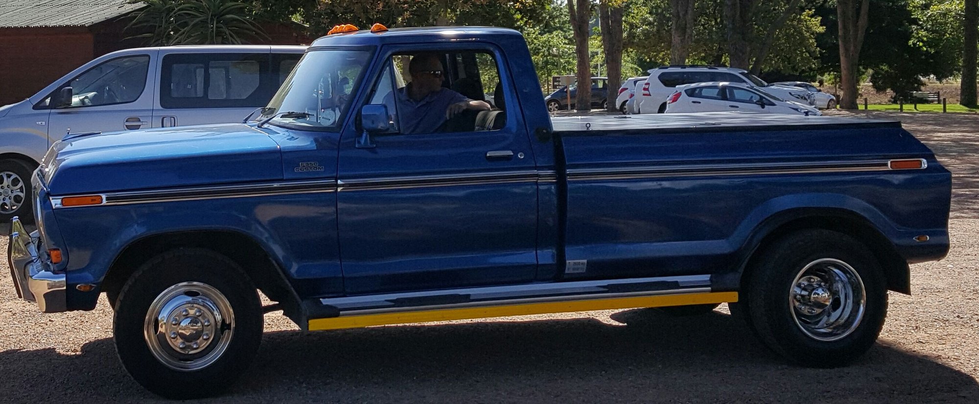

Interesting rear bed panels. Any more pics of the rear end? What's the reasoning behind the slant?

Haha, that slant is a sore point.
The company I bought the truck from used it for towing cars while filming them.
Prior to them owning it, it may have been used as a breakdown tow truck.
I believe it was originally a long bed, and one of them cut it shorter.
The only thing I like about it is that the entire back end is 1/2'' thick steel.
In fact with the recently added new tow bar, the back end is like a tank (an invitation for drunk drivers).
The two variations of bed covers below are now both in the bin. I didn't like either. (The nasty reflective crap is required by law here. )
The one I'm about to make will have the tailgate hinged similar to the OE trucks, and running straight down at the start of the slant, instead of having a bend in it.
Anyway, anyone with an unmolested tail section will have an easy time making a decent looking cover.
