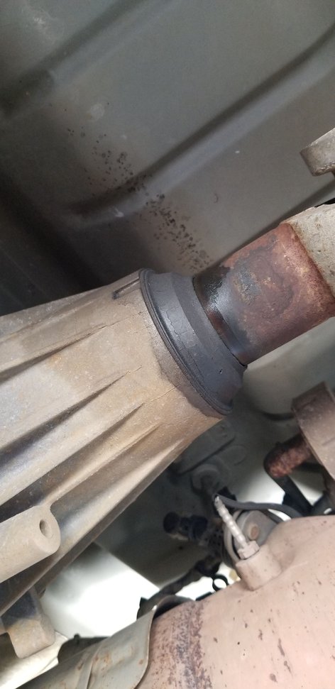

I've searched through the threads and cant find anything on this. I'm going to be replacing my driveshaft because of a significant dent. I noticed the seal at the transfer case has some oil around it and appear dry rotted. The problem is, I cant find that seal anywhere, the seals I find look different. Maybe it's called something else? Any help is appreciated

It is a rear transfer case output seal. What you're looking at in the pic is not the real sealing surface. The aftermarket seals can look different or lack something , but work. That is like a dust boot built into the seal, which a quick online search of an auto parts store didn't have in the pic. If you want exact you might want to go to your Ford dealer.
