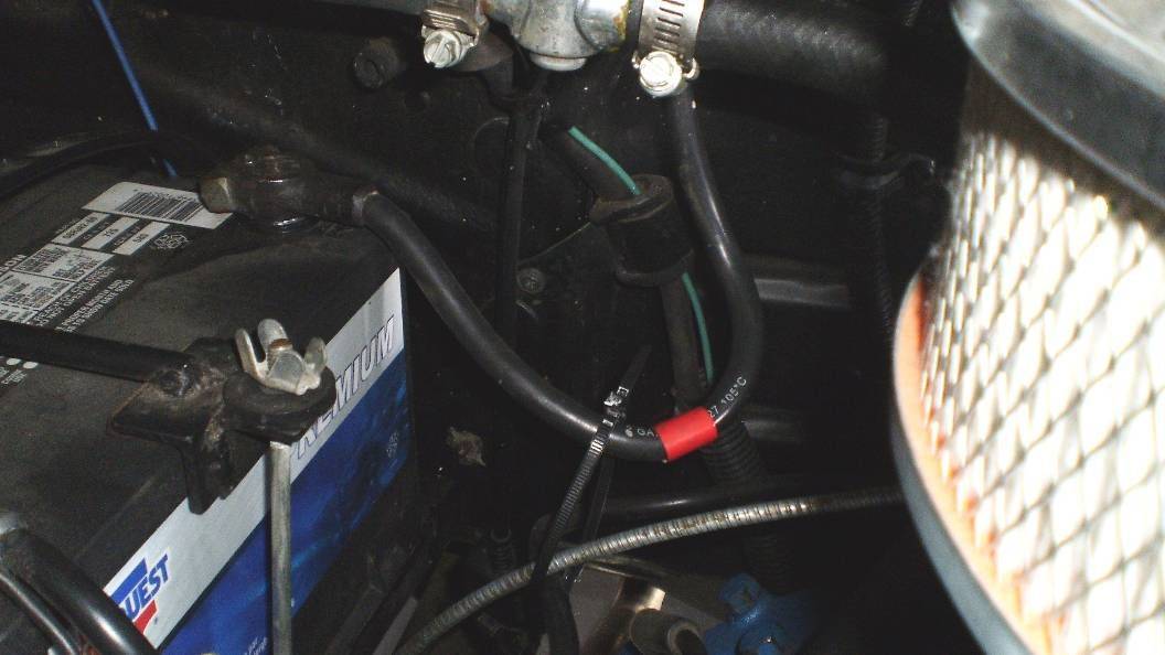

I have searched the web to no avail, so I figured that it was time to ask.
does anyone have pictures of the routing for the starter cable from the solenoid to the starter for a 51 F1? I just cant figure out where the grommet lined steel stand is located and how the cable is routed.
Any help would be appreciated.
John

Assuming it is a V8, the clamp goes as shown. Note my cables are reversed from "normal", the RH side of the starter relay normally feeds the starter.

Flathead V8.
