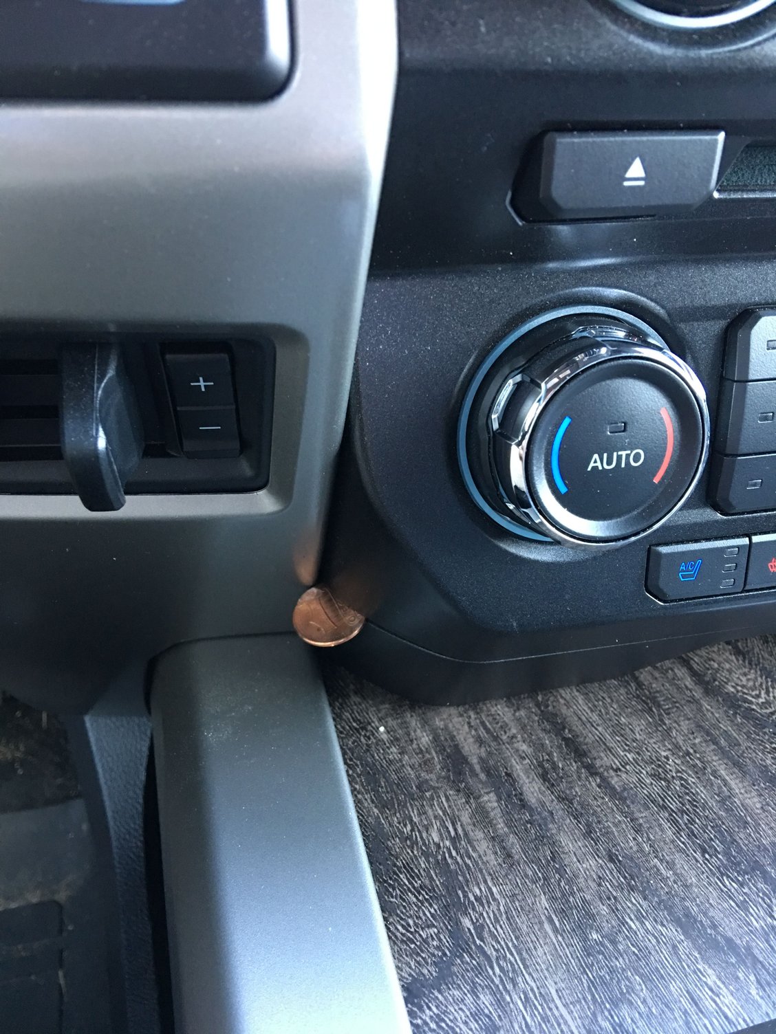

17platinumsfl, I’ve had the same issue. Come close to ripping the bottom of the center stack off. Found that when I pushed on the bottom of the center stack the noise would go away. I finally stuck a penny (it was in the cup holder so that’s what I used) between the bottom two sections of the center stack on the driver’s side. Just needed something to jam between the two sections to stop the squeaking noise. Amazingly that’s the cheapest fix at $.01. Hope this helps. May even help the OP, but sounds like his noise is higher up.
