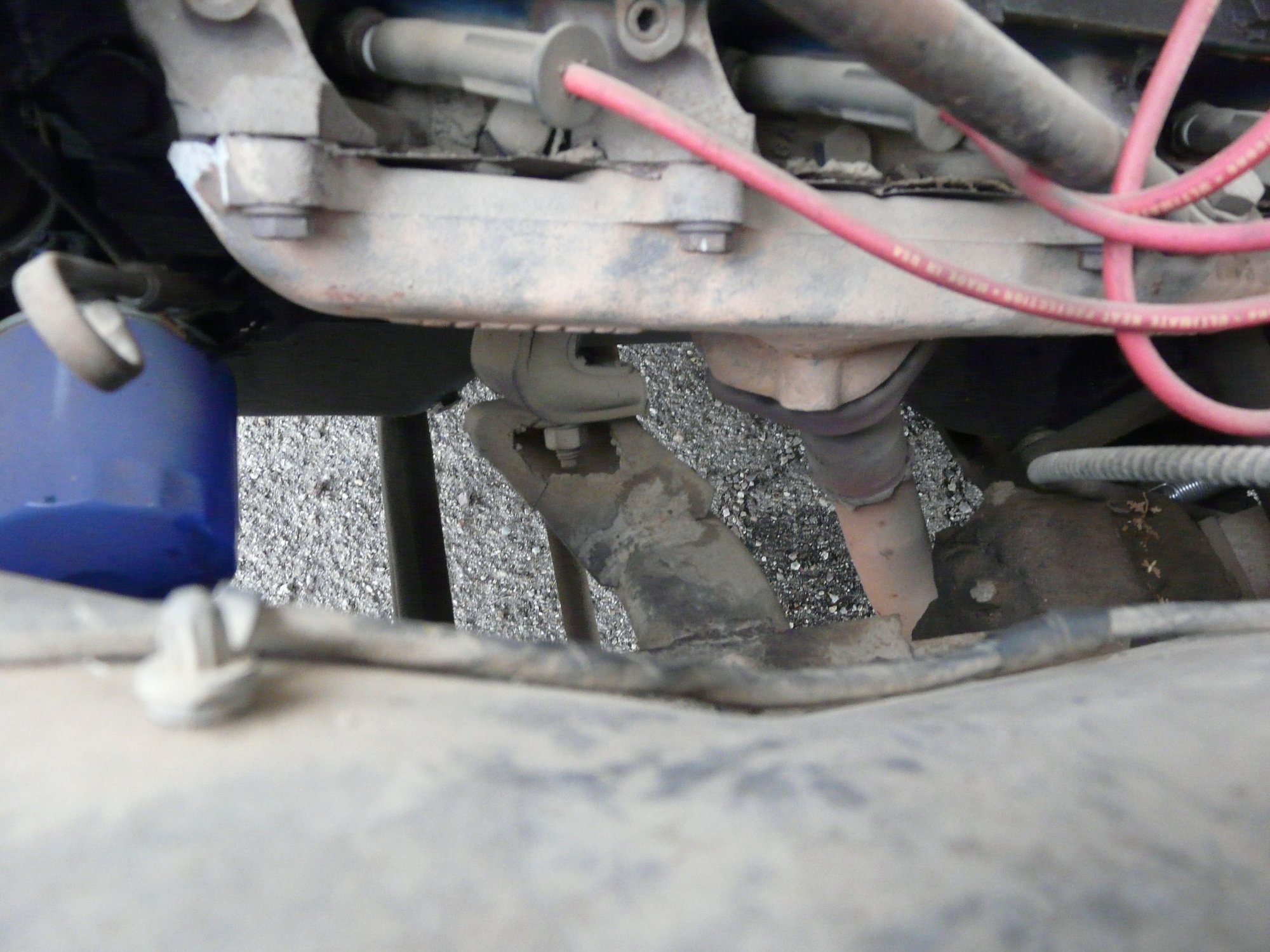

Thanks for the advice. Just to be clear, My engine doesn't use the single forward mount. There are two. One one either side of the block, attached to a cross member.

Haha! In your first post you said there are two mounts on either side of the bellhousing, Yes, and well forward of the bellhousing at that, eh?
