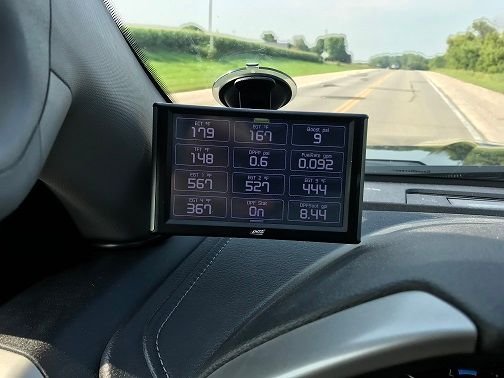

yeah mine was way off. Have you ever done a manual regen using the cts? And off topic but do you have a pic of how you mounted your cts2?

Yeahs that’s usually what I watch also. It got up to 8.54 I believe. Where did you mount your cts? No one makes a mount for the A pillar.

Next to the A pillar

Yes , I did a manual regen with the cts shortly after I updated it . Worked basically the same as the manual regen on the truck . My cts is mounted with the provided suction cup in the same place as the pic screwy posted above .
