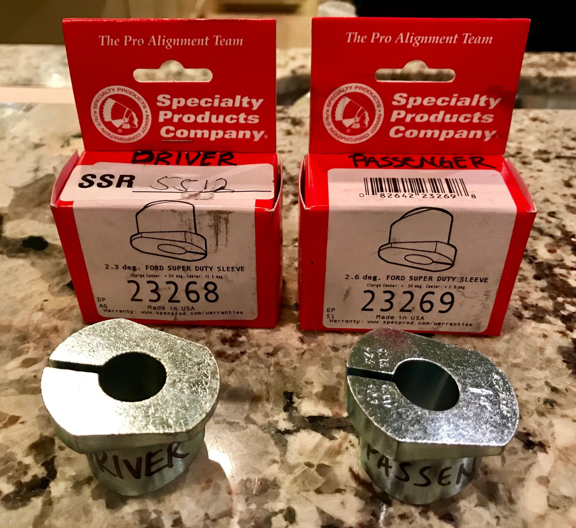

Thanks everyone, think i will check the caster readings on my truck, i did not keep the alignment report, and try to get it to +4 if it is not there now. I will see how it drives after that before changing shocks or doing anything else.
I’ve posted this pic 3 or 4 times now. I added these to my 2.5” level and it made as much difference as the Fox steering stabilizer did - a great improvement on both accounts.
Are those still needed with a lift kit that includes radius arms?
I know the BDS Radius Arms use a Cam on the lower axle bolt to position the axle back to stock Caster, they can be used for either 4" or 6" lifts by flipping the cam.
That's my current first choice. Thanks.
