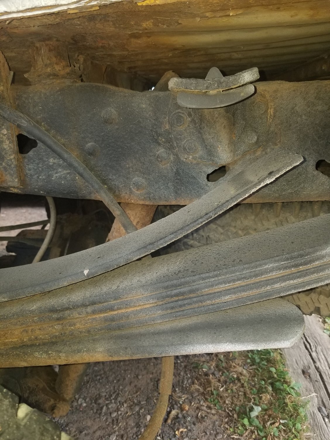

Edit: took picture from wrong side. The hole is there but it appears to have never been used. 99 F350 with camper package

Originally Posted by p38fln
F350 framerail driverside rear axle
If you look at the exact same spot on my frame rail as in the one that does have one, there isn't even a hole for one to be attached. I also have the camper package.
That's a picture of the frame behind the axle. The end link attaches to the frame in front of the axle.
Old Aug 21, 2018 | 09:19 AM
p38fln's Avatar
p38fln
Joined: Jul 2018
Posts: 137
Likes: 29
From: Northern MN
you got me before i edited the picture, sorry! I would have just replied if i had known anyone had already seen it
