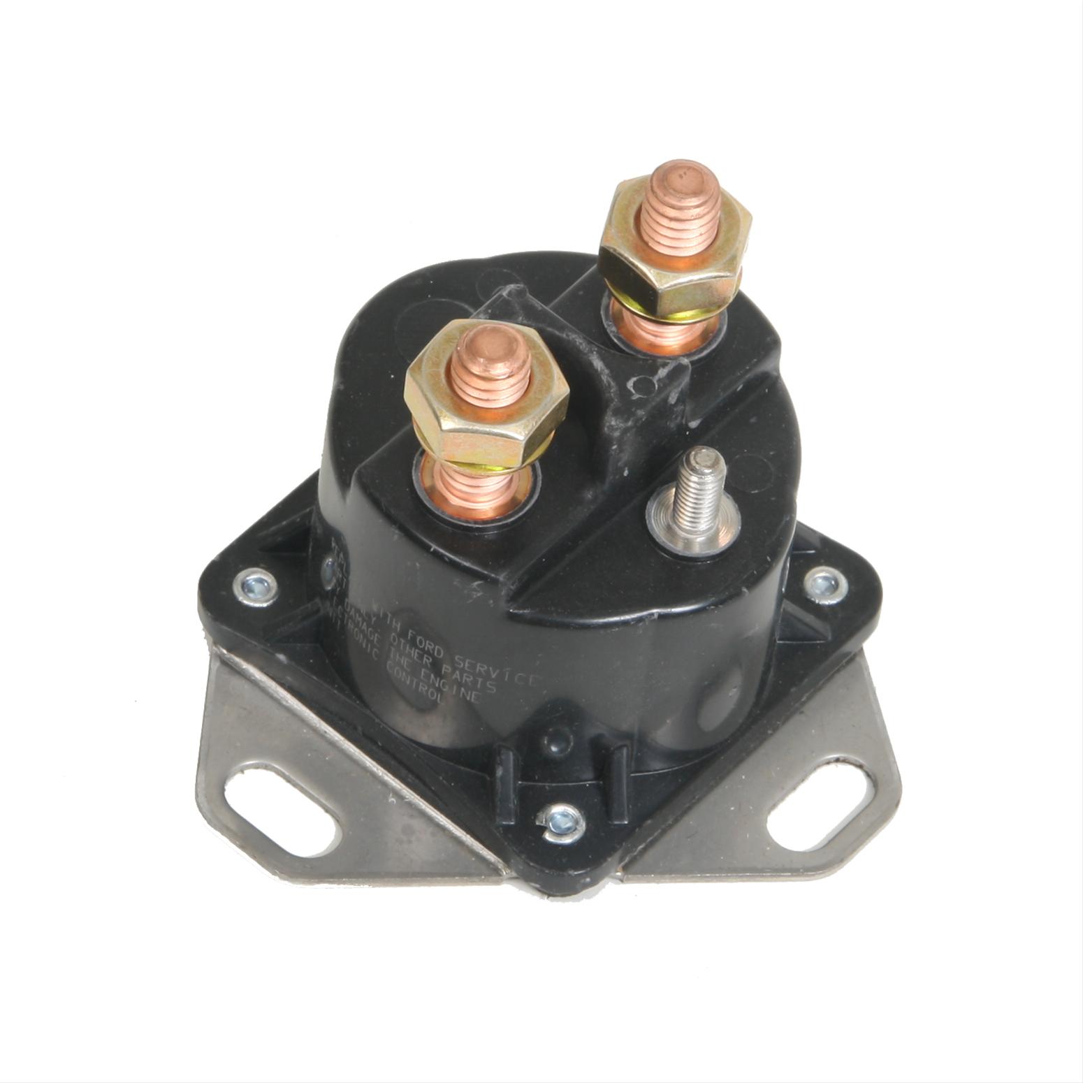

#2 - When you say "ignition does dead" - when you turn the key to on, I assume all the lights in the dash come on and it's just that the starter solenoid doesn't engage. Instead of jumping the two BIG terminals, try jumping the small terminal to the BIG terminal that goes back to the battery. If it doesn't crank, the solenoid itself is bad. Because of underhood heat, a bad connection in the solenoid will open up because the entire thing expands because of the heat and the connection opens up.

(#2) "I assume all the lights in the dash come on and it's just that the starter solenoid doesn't engage." Correct, not even a click. "a bad connection in the solenoid" The fender mounted solenoid ?? My brain goes directly to the starter solenoid, so when it starts by jumping the 2 Lg. terminals I ruled it out immediately.

Starter solenoid (really a huge relay) - the picture is probably is not exact, but you get the idea.
Jump the small terminal to the + side of the battery and see if it cranks. If it doesn't crank, the solenoid is bad. If it DOES crank, something upstream from there has a bad connection. I believe there is another relay upstream from there.

YES, Thanks. The pic is close enough & it is mounted on the fender well. NOT THE ONE on the starter (if there is on there)...
You should not have. The relay (it's NOT a solenoid) has to get its input signal on the small wire in order to operate. If you jumper the small terminal to the large on that goes to the battery and it cranks, then the relay is good and your "no crank" issue is due to something "upstream" from the relay. Wiring, fuse(s), DTR switch, and ignition switch are all part of that circuit. If you have an aftermarket security system, it may have added a starter interrupt as an anti-theft measure.
