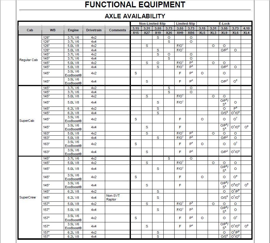

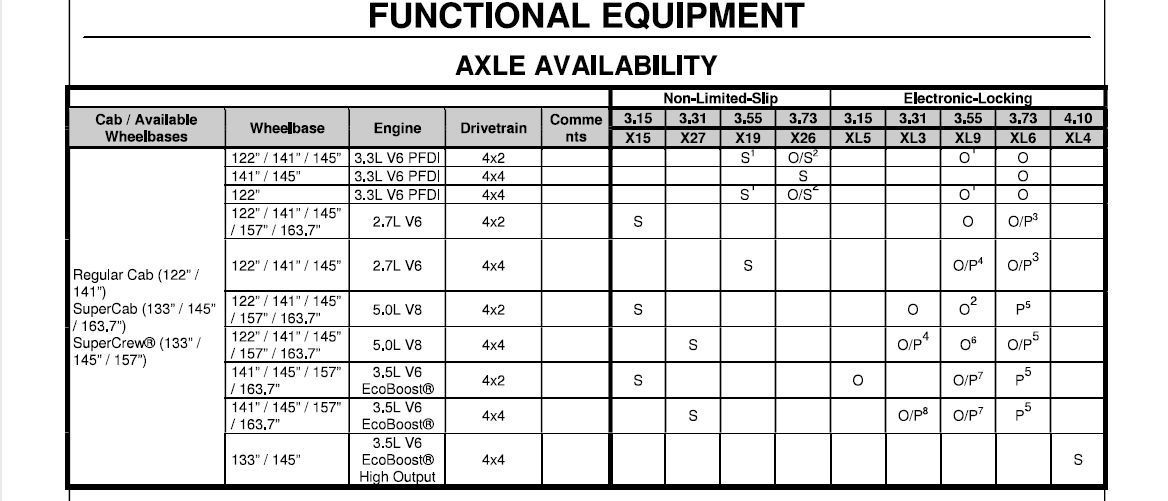

AlaskanEx - We are discussing 09-14 trucks correct? They dropped the limited slip somewhere between 12-13. I know you're all about facts so I can't believe you haven't dug up the exact day they stopped offering them.
Excerpted from the 2012 F-150 order guide ...
Excerpted from the 2013 F-150 order guide ...
Excerpted from the 2014 F-150 order guide ...
2015- up no limited slip is offered either.
The gen'13 F-150s' limited-slip rear differential is the electronic-locking rear differential.
Excerpted from the 2015 F-150 order guide ...
Excerpted from the 2018 F-150 order guide ...
BTW ... Have electronic doc' back to 1993 for F-150s, and can excerpt limited-slip rear differential information. Additionally, have owned various 1967 thru 1986 F-series with factory, optioned limited-slip rear differentials. Though not so for the F-1s that I've had.
