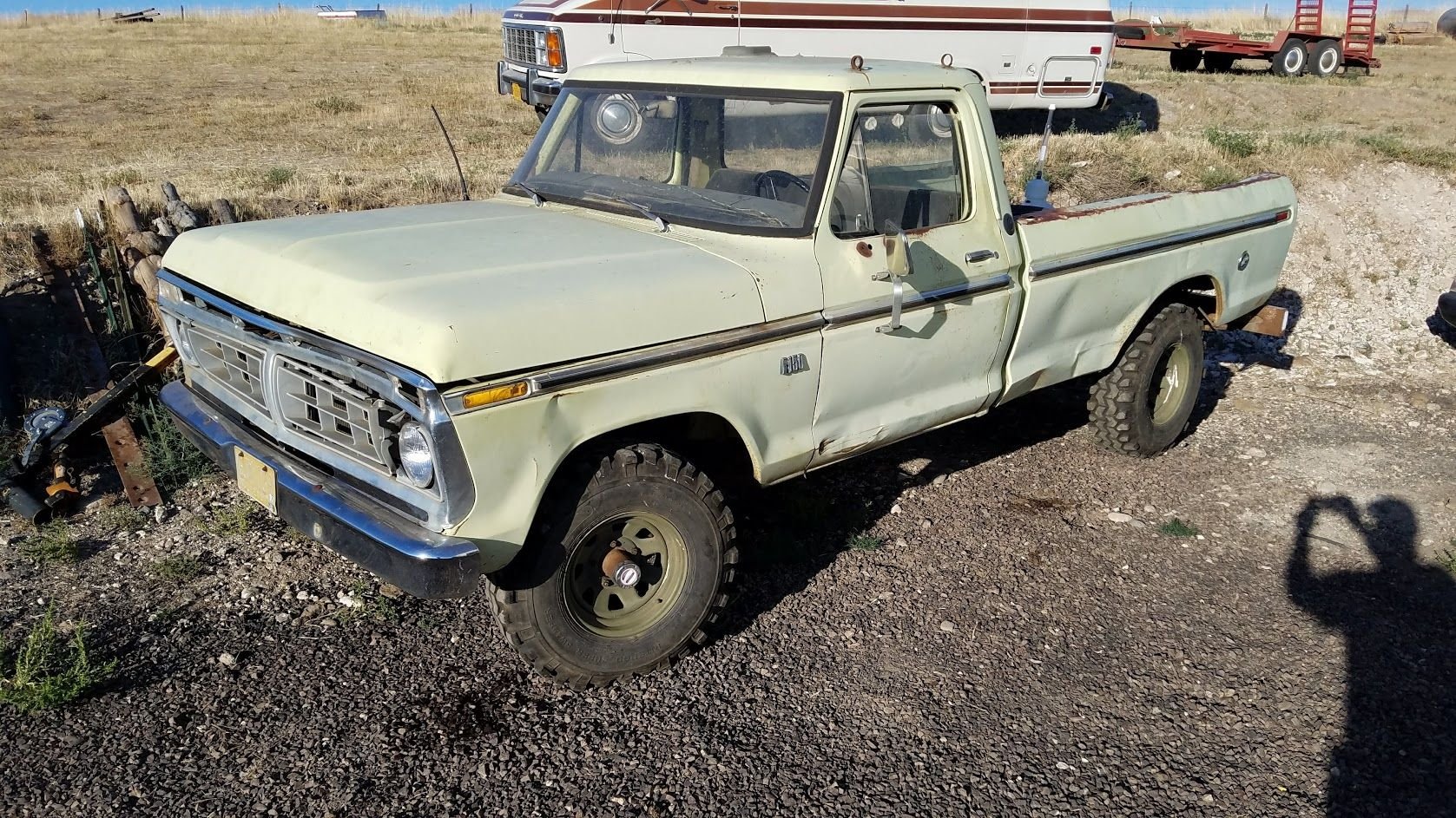

Hello,
I purchased a cheap beater 1976 Ford F-150 4x4 with a 360 / 4 speed recently to teach my kids to drive a stick in a pasture. The rest of the time the pickup will stay on a ranch and used to haul wood, build fence, etc. Doubt it will get 100 miles a year on it. I knew the engine had a knock when i bought it but was hoping it was a bent push rod but after narrowing down the noise to bottom/rear I pulled the pan today to inspect the 4/8 rod bearings. What I've found so far looks to be the bushing in the #8 wrist pin is shot. Rod bearings on the crank side are worn but not shot (a little copper showing through in a spot) but with the rod caps removed the rod has lots of play in the wrist pin and I'm pretty sure I can see a little bearing coming out on one side up there and I found a little bearing debris in the pan.
Does anyone know if the wrist pin can be removed and rod pulled from the bottom on these engines? I haven't tried to do it yet, thought I'd better ask. I'd like to avoid pulling the head as we all know what fun that is on an FE. I'm going for the quick/cheap fix on this engine considering it's future use. The engine also has one push rod that's not turning when running so this isn't it's only issue but I can live with that for now.
The cylinder thatching looks to be gone in the cylinders where the rings are. The truck has 78k miles on the odometer but I bought it from the original owners and it was used on their ranch as a spray truck since new. My guess is the engine has considerable idle/running hours as it was once fitted with a PTO to run a pump and had a manual throttle setup.
If i can't do the repair from the bottom I may just park it until I can find a cheap used running FE to swap in to it.
Thanks,
Jordan
