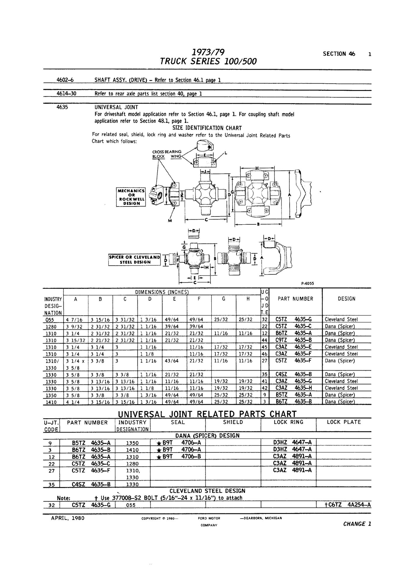

Here you go maybe this will help.
This is somehwat helpful, but I don't see a match between the U-joints I measured and the chart you posted. I guess I need to take more "B" measurements with my u-joints? Weird how Spicer goes cap to cap, whereas the chart you posted goes "out to out" with the needle bearing cap removed.
EDIT: I also have no idea how to determine the correct u-joint that has both the 1-1/8" diameter cap, AND the 1-1/16" diameter cap.
