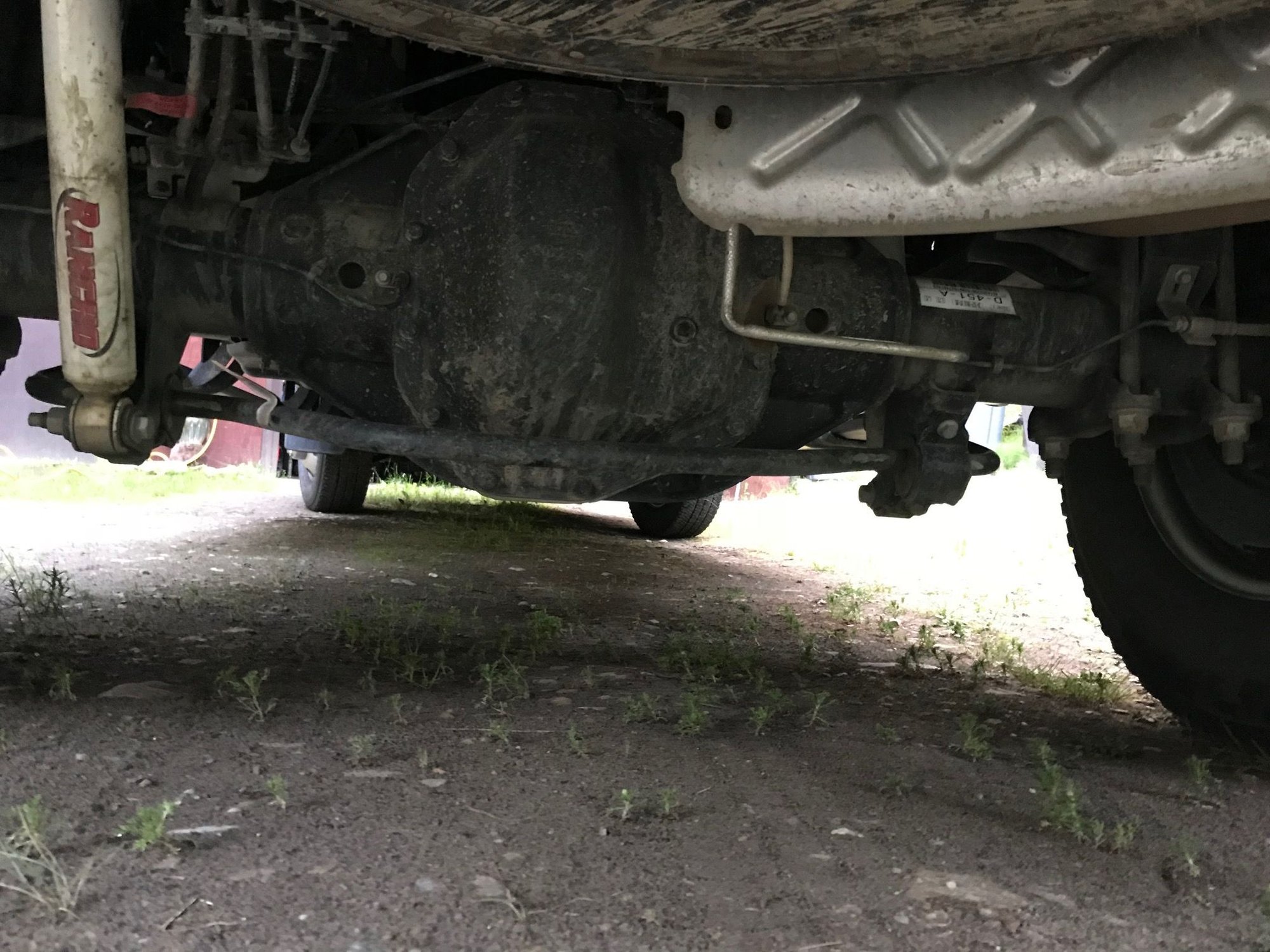

Okay. I've heard only Good Things about these axles but am finding it frustrating not being able to find hard specs from Dana on them. I frequently carry a lot of weight in mine. When I research D-451-A, I come up with Dana docs on a D-451-P that's rated at 40,000 pounds.
Pics of my rear end. Ain't it sexy?
