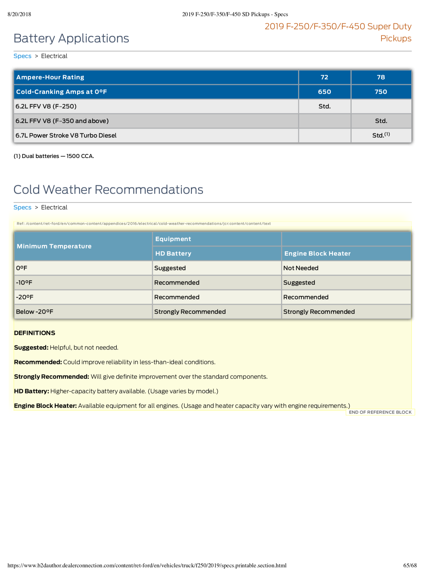

Here are Ford’s battery- and block heater application recommendations from the 2019 Specs brochure.
HTH,
Jim / crewzer

Interesting ....
Why does the F250 with 6.2L not get the same battery as the F350? What is unique about that same engine in a slightly different chassis that causes a need for more CCA?
Old Jan 22, 2019 | 07:07 AM
  #43
crewzer's Avatar
crewzer
Joined: Apr 2000
Posts: 4,334
Likes: 306
From: Mills River
Battery size difference theories:
1) ATF volume? The F350 6.2’s 6R140 holds ~55% more ATF that the F250 6.2’s 6R100, so the engine might be harder to start when the powertrain is cold.
2) Smaller battery = lower cost; bean counter at work?
3) Marketing? Does the larger battery help reinforce the F350’s heavier-duty image?
HTH,
Jim / crewzer

I would think that ATF volume is mute at startup, but I'm an electrical guy with a surprising lack of experience & knowledge on the mechanical side, especially transmissions.
2 & 3 seem the more likely reasons. There are more & more people, myself included, that buy more truck than they need. We've all watched trucks evolve over the last couple of decades. The 150 has become the quintessential family sedan while the 250 has become an entry-level "work truck." From my observations, if upfitting is a serious plan of action, the 350 is the starting point, so it is likely that the greater CCA is to account for the greater likelihood of accessories (load). Especially since a lot of guys don't necessarily wire accessories in properly. One of the best things Ford ever did was to start putting the upfitter switches in the Supers. I wish they would make them an option in the 150s. It would save my dad (& me) a lot of time spent fixing hack jobs that come into the shop. Although, now that I think about it, that is easy money, especially since I have to charge labor to both remove their bad work & to reinstall it properly....

But it's my understanding that F250s optioned with the "Medium Duty Battery" gets two of the same 750 CCA batteries. Can anyone confirm?
