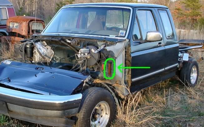

Some helpful photos from Subford:
Attachment 284704
It comes out on the engine side of the firewall. You can use a broom stick to pry down on the inner fender liner a bit to gain some clearance. Others have simply removed the liner to gain easier access/clearance.
