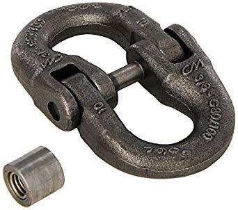

That's interesting. My 1/2" CM Hammerlocks had a spring in the center bushing to hold the pin. Went in with a few gentle taps with a small ballpeen hammer with a deadblow for backup. I also had mine powder coated.
This shows what the bushing looks like.

I just purchased the 1/2" hammerlocks for my F350. The best way to install these is to hammer the pin into and through the bushing a couple of times. I just used my bench vise to facilitate this and a punch. Then I added a few drops of WD40 to the bushing. I placed a small sledge hammer on the back of the hammerlock that my wife held and the pins drive in pretty easy. I'm not worried the pins will come out without using a punch. Still very tight but definately the best way to assemble without damaging your hitch. One additional thing I did which may have helped was to use my bench grinder to define the small bevel on the end of the bolt, very minimal grind for a few seconds is all I did.

Exact same as mine. It was a spring inside a solid piece of tube. And went together nice and easy. I have the CM Hammerlocks as well.
