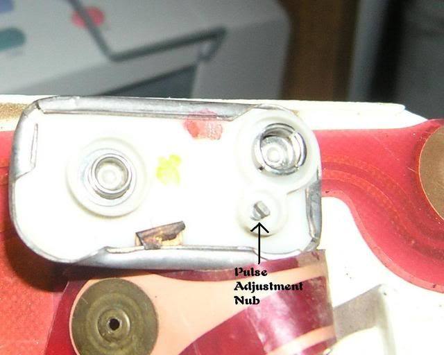

Is it only the fuel/temp gauges, and not oil gauge too? If it were all three I would say for sure a bad ICVR. It's still possible it's a bad ICVR but somewhat odd it's only two gauges affected and not all three (the ammeter gauge is not part of ICVR circuitry).
You can try adjusting the pulse on the ICVR and see if that improves anything (it should read about .5v every second when tested).
