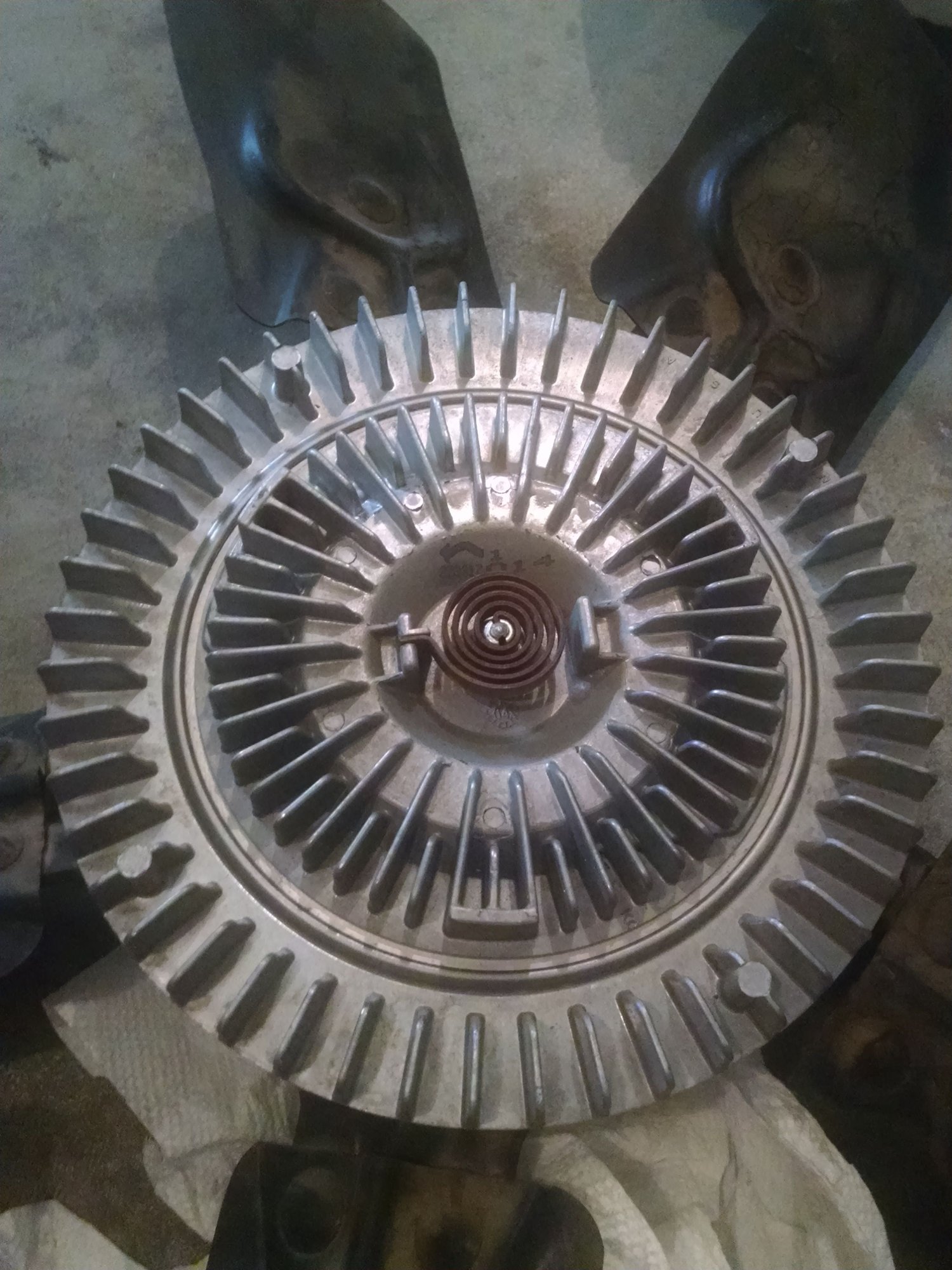

Well, armed with your advice and some time on my hands this weekend, I am finally throwing the new parts in. I have removed the fan clutch and shroud. I already have a couple questions.
First one: the fan clutch that I pulled out has the exact friction that the new fan clutch has. Is there a way to test these? It feels like compressed gum when turning the shaft.... Meaning it turns (and smoothly), but not freely. I'm going to read up on how these clutches work, but should I put the old one back in until it burns out or I figure out why itsi always engaged? And is there a way to test if the clutch is still good? I will attach a picture below. It looks brand new.

Okay a little reading convinced me to replace the clutch regardless.
A bad clutch bearing will blow out my new water pump bearing so then I'd be out even more money and time.
And mine is a thermal clutch, so despite having a "cold " engine, I believe it was 90° out when I looked under the hood at idle. Ambient temps were probably to warm to disengage tge clutch and the rpm was too low to break the friction of the silicon gel... Double wammy.

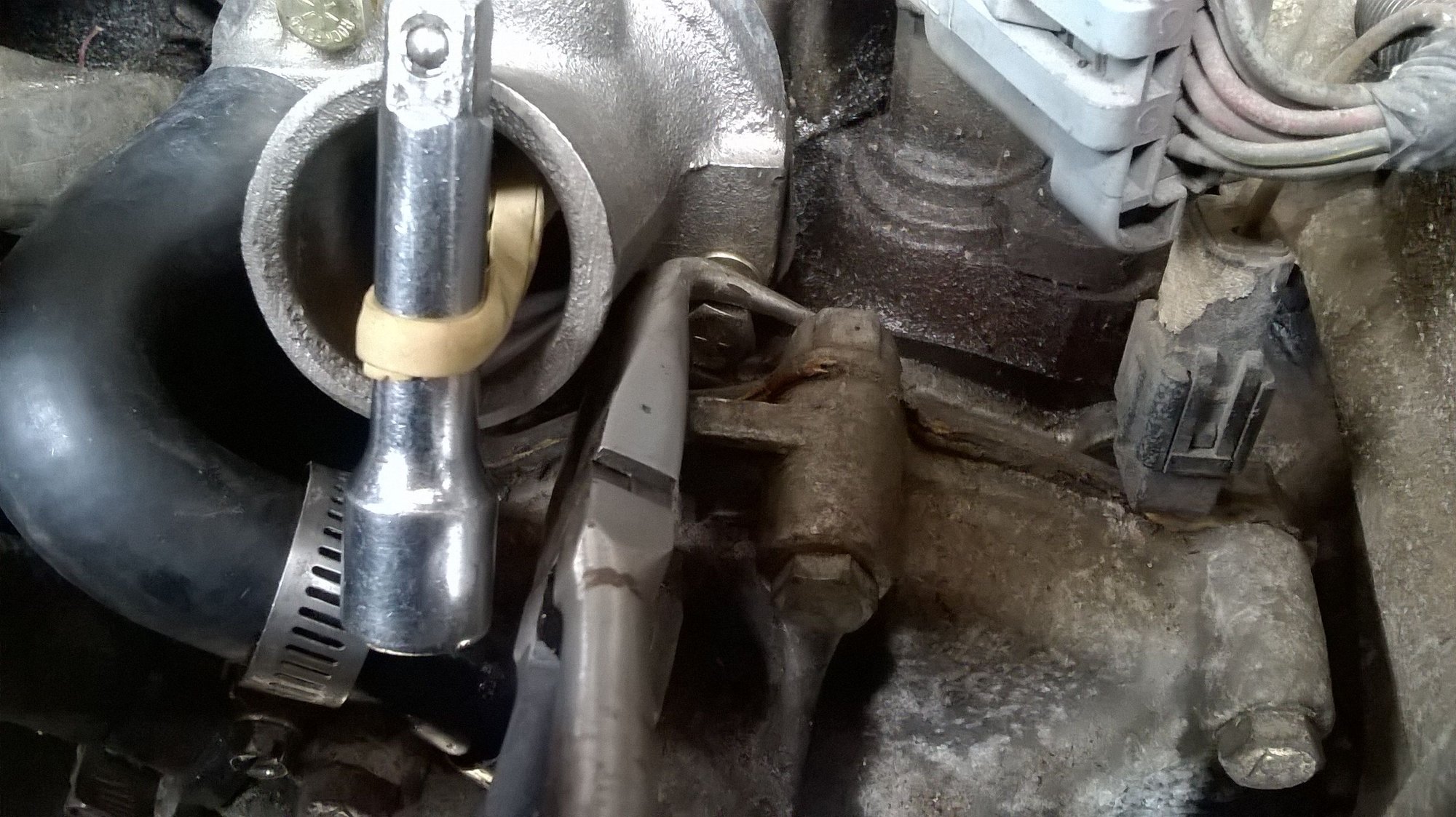

The parts are in. New radiator, water pump, thermostat housing with temp probe, and hoses.
I also put in a glass coolant filter. It's actually really easy to see when the thermostat cycles now. The cycling is happening around 200° according to my backup tempd gauge 😎 Only thing is, the temp probe in the thermostat housing is not sealing.
Would you recommend I try Teflon tape again or use permatex indian head water seal or do something else?

I sealed my temperature sensor with Teflon tape. But some kind of goop should work also.
