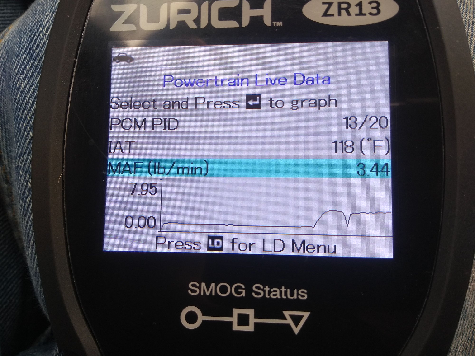

When I changed the PCV, I didn't use motorcraft, I used whatever they had at advance auto. Sorry about the last video, I took another video with freeze frame data showing the long term fuel trim and short term, I'll post that in a minute. I'll also get you the maf value in a few minutes
https://youtu.be/oMtlIRyfom0 this is for fuel trim

Originally Posted by Collision
When I changed the PCV, I didn't use motorcraft, I used whatever they had at advance auto. Sorry about the last video, I took another video with freeze frame data showing the long term fuel trim and short term, I'll post that in a minute. I'll also get you the maf value in a few minutes. The first picture is the truck off, second is at idle and last is at 2500ish, the blip in the graph is from me over shooting 2500 and having to drop back down
The video isn't Shakey since it was just a frame by frame of live data

Did you verify the PCM was in closed loop as instructed before getting those MAF readings?
Old Jul 4, 2018 | 09:21 PM
Collision's Avatar
Collision
Joined: Feb 2016
Posts: 493
From: Royersford Pennsylvania
I assumed... Because the check engine light was on I assumed it had done it's thing, are those values off? Should it show anything when it's not running?
It was closed loop, checked it again. Now what?
Do only ONE THING AT A TIME. Retest after each.
1. Clean the MAF sensor elements. Re-check and compare the hot idle and 2500 RPM MAF readings before and after. Your current readings are too high and it appears the MAF is mis-reporting the intake air mass.
