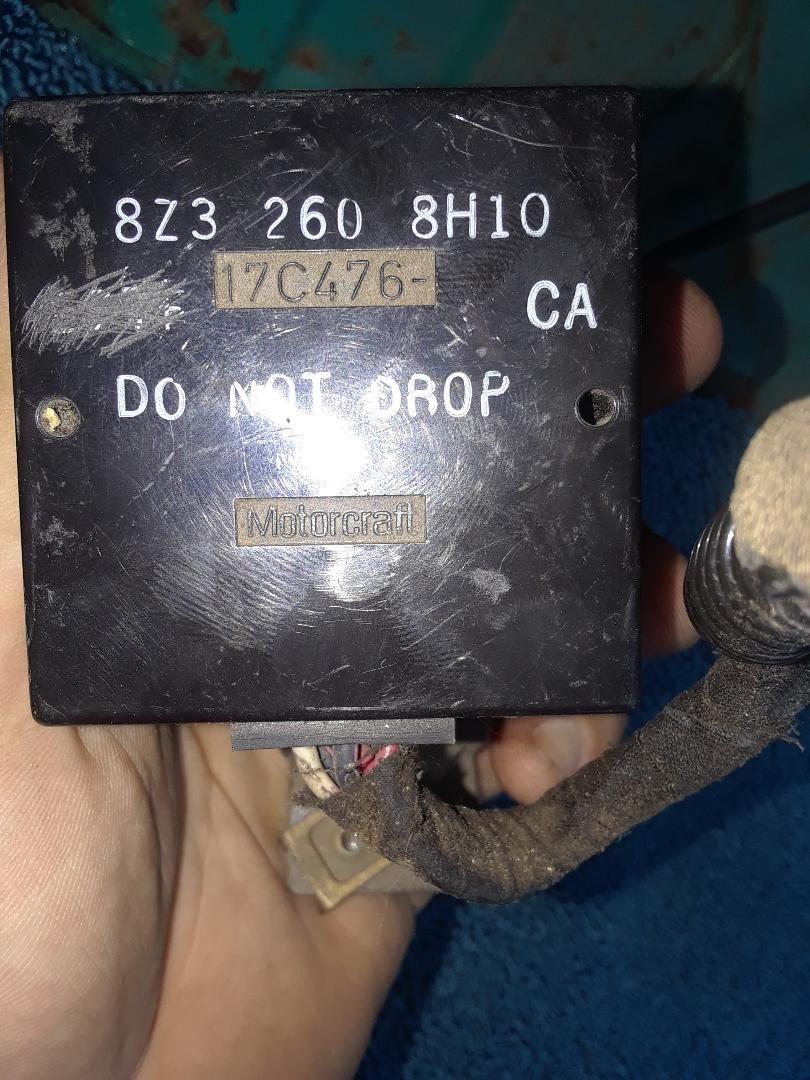

after a little research I found that the wiper switch from an 87-88 pickup with the intermittent wiper box is a perfect fit, no wiring changes and works great. its kinda nice to have the intermittent option too. the part #on the box is 8Z3-260-8H10 and has another # 17c476

these are the only # i ca see.
This is the intermittent wiper governor, someone has scratched out the ID numbers prefix of E7TF // Visible is the 17C476 basic number and the ID numbers CA suffix
E7TF-17C476-CA .. See post #10.
