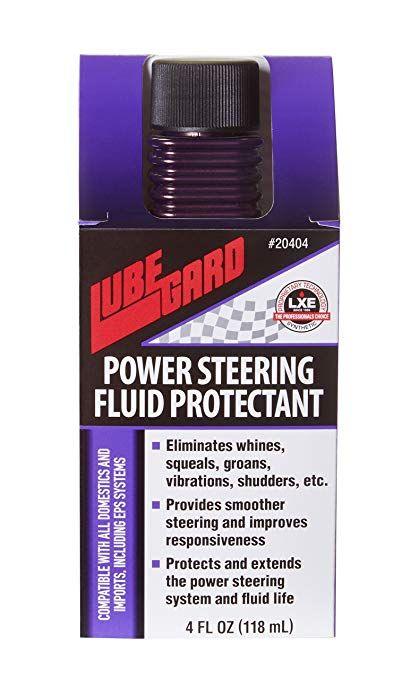

Change the fluid and add a bottle of LubeGuard Power Steering Fluid and Protectant. It's cheap, and if that doesn't fix it, nothing will. I have fixed some of the worst sounding pumps imaginable with this and a fluid change. My old Aerostar being the worst.
The packaging has changed, but it will be in one of these bottles. Some will scoff, but for $5.99, what have you got to lose? It definitely works.

I think I will start with just changing the fluids and make sure that I use the correct stuff. Its worth a shot and doesn't cost a whole lot. The steering is still smooth, its just the noise. Then if that doesn't work I will change the pump out. I'm in Canada so I am not seeing the Lubegard power steering additive at any of the local places but i'm sure I can find something similar if I look hard enough. If it comes down to changing the power steering pump I would hope that my local Ford dealership would have the pulley removal tool and I could get them to swap it to the new pump.
