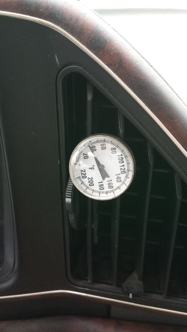

Mine was doing the same thing two weeks ago. My buddy put in a new compressor and a new orifice. He said the new orifice is very important. Mine was black and they call it the black death. One video I watched the guy did what I think is a good idea. He put his new compressor in and cleaned his old orifice. He then put the old cleaned orifice back in and ran the system for 30 min or so as I recall. He then pulled it and it was nasty again from what was left in the system. He then put the new orifice in and all was well at that time. As far as I was concerned, I was going to convert but it had already been done. I didn't want to have to hunt for the new R system freon and it is very expensive. I am not knowledgeable about A/C systems so this is just my experience. My A/C is working in our 100*+ temps now so mine is good. Sandy
